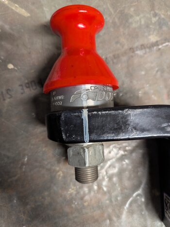

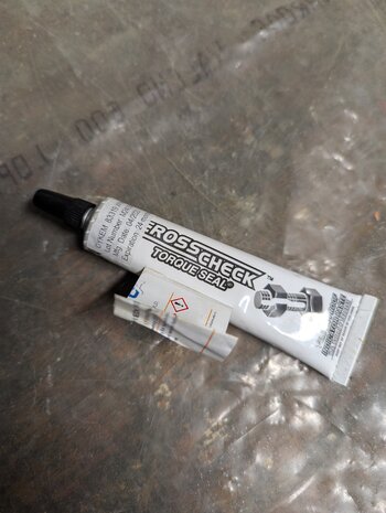

There are specialist products like Torque Seal (I found some old stock in my shed).
Don't use the same green pen. That's the colour my agent used also and that cannot be a coincidence. Use a different colour for bolts that you mark so they don't get confused with an Ineos service campaign.
Those link bolts are a single use item. They're supposed to be replaced if they get removed. When that same campaign was done on my vehicle in July six bolts 'failed' a torque check so were replaced. It was odd that any failed and improbable that six failed. They're a substantial M14 bolt. I asked my agent how they did the torque check. I'll leave out the details and simply say, badly. Some bolts were replaced unnecessarily. A learning experience for a young apprentice...
Edit: Torque Seal inserted and pics added for reference.

The benefit of a specialty torque-seal product like I posted and @landmannnn also mentioned is that it can be removed with a plastic (preferable) scraper and doesn't leave any significant residue. It's a thin plastic bead that hardens when exposed to air. It's really intended for critical fasteners that get disturbed or torque checked semi-regularly during maintenance or repair hence the temporary nature. It's easy to remove and reapply when required.
For fasteners that rarely get touched but you still want a visual confidence check then a paint pen or a marker is fine albeit with a little more work to do to establish a new mark whenever the fastener is disturbed. Or, do as my agent did and use a new colour each time they messed with the trailing link bolts. In that sense they're being used as a QA check not a creep check, same as the factory marks.
