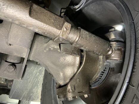

I know it's not a proper threadlocker, but because we have a lot of salt on the roads here in Germany during the winter, I sprayed all these bolts with underbody sealant shortly after taking delivery of the INEOS. You do get your hands dirty working on these parts, but it prevents corrosion on the threads and also ensures that water can't get into crevices and damage the threads.
Plus, you notice immediately if a nut comes loose.
If this keeps up, we'll soon have to do a "pre-drive check" before every trip. IMG_3426.jpeg

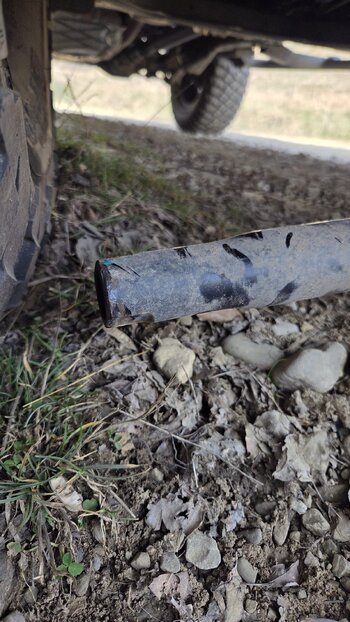

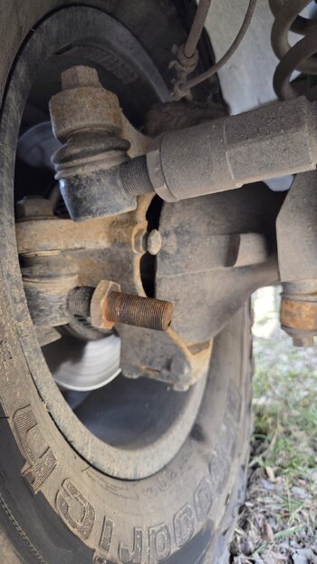

Happened today. It’s kinda scary that this could had happened at greater speed. I will escalate this to my dealer as i find it’s a very dangerous problem.

I'm wondering how this could even happen. If I compare it to my vehicle (see picture above), the lock nut on the vehicle of "Alex Adv" seems to be still in its original position. Even if it had come loose and moved outwards, that shouldn't matter. The force transmitted from the wheels to the steering rod is transferred from the external thread of the track rod end to the internal thread of the steering rod. The lock nut plays only a minor role. If it's in contact with the steering rod, there might be 10 mm more of the internal and external thread engaged, which absorbs the load, but does that really make a significant difference? Furthermore, I'm wondering how the thread of the track rod end, which was inside the steering rod, could have rusted so badly? The "hidden" end is more rusted than the exposed thread in front of it.
Since the steering rod can't rotate on its own with the track rod ends installed, I suspect the thread inside the steering rod has stripped.
How can something like this happen? Is the thread in the steering rod too soft, or were the threads already rusted when the track rod ends were installed?
Checking the steering rod for loose locknuts won't help, because this damage then can also occur with tightened locknuts.
If the jam nut is not tight then you have play on the threads. This will quickly wear out the threads of the softer tie rod. As well, the stupid design of the tie rod causes the whole assembly to flop up and down if everything isn't set just right and tight.
Even if you have the jam nut reasonably tight the flopping action of the tie rod can loosen the assembly. The Jam nuts really have to be pretty brutally tight.
