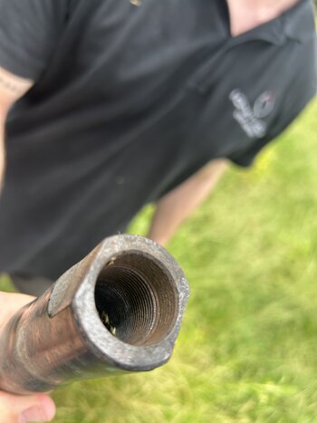

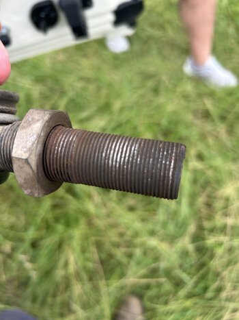

Update: @Dokatd - mate, looks like you were spot on.
The threads between the tie rod and tie rod end, had been worn down over a long period of time. Likely caused by a loose lock nut. See self-explanatory video and photos.
Maybe something for the wise to watch out for.

Loose lock nut removes the tension and gives play until the threads were gone?

FRAP Italy supply the steering and suspension links to Ineos. FRAP has been supplying parts to multiple brands since 1932 so it's fair to say their design is ok - provided the jam nut is tightened. This is a process or maintenance error because the nut appears to be left loose. Was there a wheel alignment done and the underpaid tech forgot to tighten the jam nut?
The design lacks redundancy such as a clamp, keyed tab washer, etc. so a loose jam nut could eventually lead to failure of the connection. That seems to be what's happened here.
A clamp that is left loose could just as easily result in a failure of the threads on either the tie rod itself or the tie rod end. The problem is not with the jam nut design the problem is a loose connection.
Doubt the track rod is even an Ineos design or part, Carraro has been using this set up for years on other trucks and tractors.
Other makes have suffered the same issues over the years when steering components have not been inspected, adjusted or secured correctly during a service or PDI inspection.
