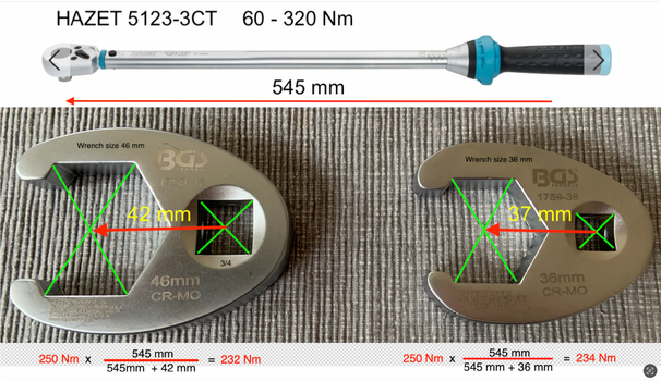

Per the service portal the torque spec for the lock nuts is 250nm or 184 ft-lb.I want to say 160ft#... I think it's somewhere in this thread but pretty sure that's right.
Cool, thanks for posting that!Per the service portal the torque spec for the lock nuts is 250nm or 184 ft-lb.
