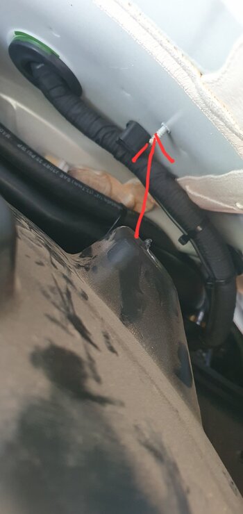

Another issue, the vapor lines coming together in the T piece supplied. The plastic pipe going into the main fuel tank, which requires cutting and fitting into the tee, is consistently larger in diameter than the tee, the supplied clamp wont seal and there will be leaks if you fill the tanks to the brim. Brown Davis strikes again...
One more thing. After fitting everything and filling up the tanks, because of the overhang weight, the distance to bump stops is 3cm, before adding anything else in the car. No people, no gear, no tent, on level ground. A lift kit is not only recommended. A lift kit or GVM upgrade IS ABSOLUTELY NECESSARY.

The vapour line T piece seems to be a GrenX mod. The BD kit has a HDPE/nylon(?) ribbed t-piece which seals very well with no hint of leaking... (I've sent you a DM offline);)

El-0000021752, blue triangle. EI-0000021753 is the only one above that (black triangle), but I don't think it's sufficient. I've ordered the Eibach Pro Lift Kit +3cm
