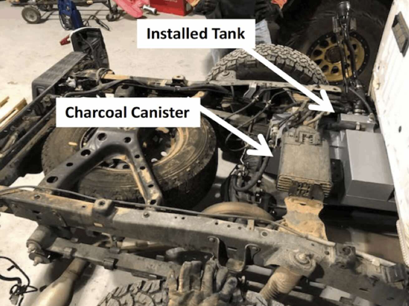

There are a number of vehicles that have aftermarket aux. tanks that sit behind the axle (just in the Toyota realm, Long Range makes aux tanks for the 5th gen 4Runner, 80 series, 100 series, and 200 series LCs come to mind). These tanks are all made of steel, and are installed in the spare tire area. As with many things in the aftermarket world, they are classified as "off road use only", my guess is that the statement is primarily to allow sales in the state of California, which is basically like the "no mans land" of aftermarket fuel tanks of any sort (even those that replace the OEM tank) from what I've read
The LRA for the Tacoma, at least for the 2010 Tacoma, is located forward of the rear axle. The spare tire is still in the spare tire area. I installed an LRA on my 2010 Tacoma and it is brilliant. The OEM fuel pump, fuel filer and fuel tank float fit right in to to LRA tank and more impressive is that fuel gauge works beautifully.
Yep, I've had the LRA tank on our Tacoma and Tundra, and both were replacement tanks. Our Sprinter has a replacement tank from S&B, however, on the vehicles that don't have room for a larger replacement, LRA does the aux tank with a small fuel pump to transfer fuel to the main tank

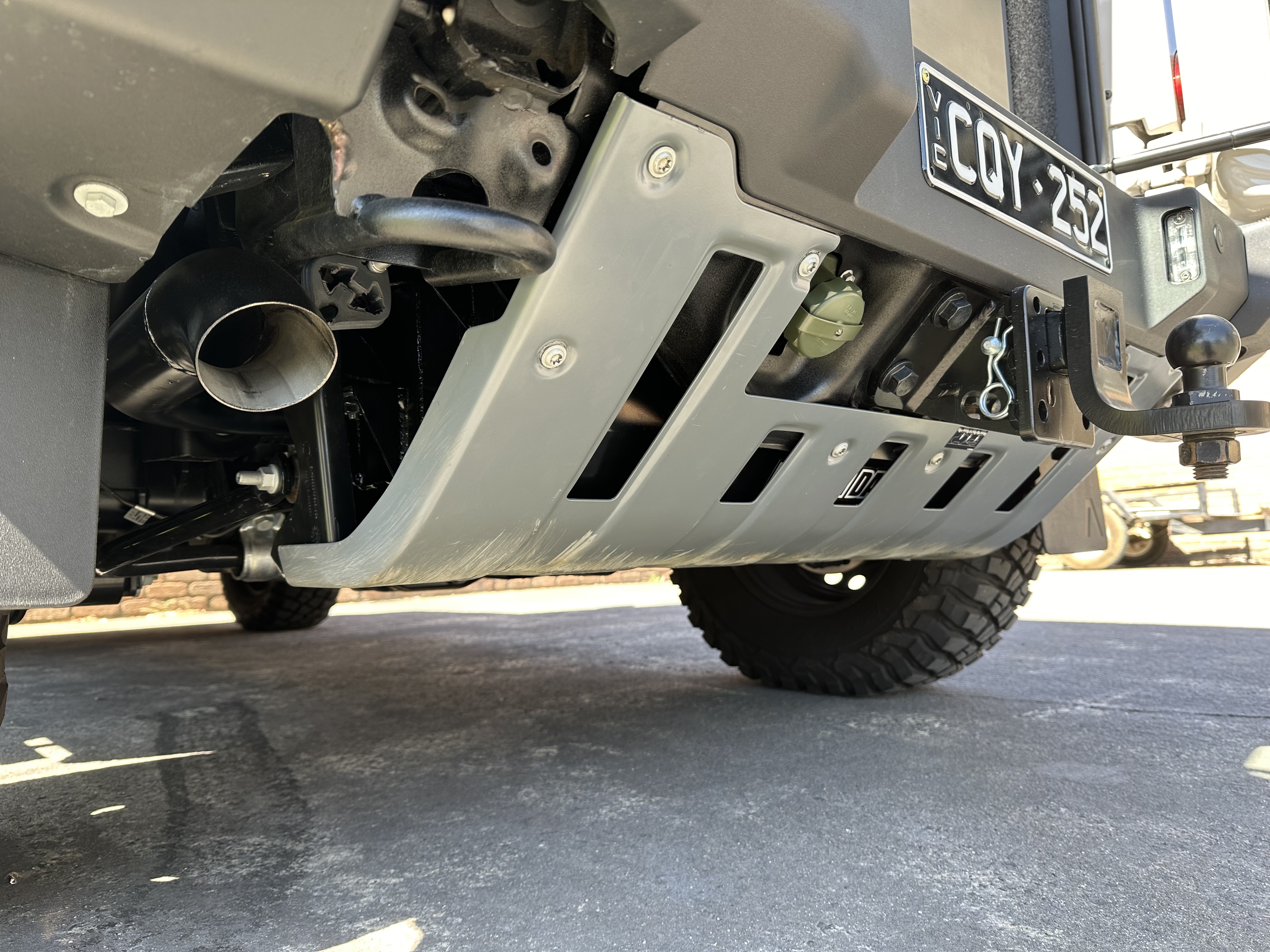

I managed to get included the larger hi flow diesel fuel filler so it can accept the truck bowsers. Production units will ready around June. $1,997 AUD plus shipping, Installation time around 6 hours. I will be taking orders closer to the production run.

I now have completed a few months of testing on the prototype 68L Auxiliary tank. Which I will pass feedback onto BD for some improvements before the roll out begins this month to optimise the system for my fellow owners to get the best results. There is also some considerations to take into account when doing this modifications.
1. I will be getting in contact with BD to slightly reroute the exhaust as I have now found on full flex the new exhaust contacts the chassis and comes very close to the Rear left side shock absorber. The exhaust needs to be moved slightly lower to create more clearance which is a easy fix.
2. For our clients I will be strongly recommending to pair the fuel tank with our Poly Air Airbag system for the rear springs. I have found when you load Roofrack + Drawers + Fuel tank the rear springs will sag and if your towing a caravan the car will not ride level. So rear airbags is a must if your planning to carry additional weight. We will be using the Poly Airbag kit in our upcoming GVM upgrade kit for the Grenadier.
3. After fitting the Tank it makes changing Shocks/springs more difficult & time consuming. There is a skill be be able to do it without having to drop the tank. If anyone is considering doing a spring or shock upgrade it would be advisable to do it before the tank goes in to make fitment alot easier.
4. We tested the euro spec Eibach pro lift springs in a spring dyno and they are more heavy duty spec, they can handle some additional weight in the rear compared to the factory spring rate that came in my personal Grenadier. We found them to increase ride height by around 45mm on the vehicles we tested so they are a great option if you would like additional clearance.

Hi guys,
I installed the Brown Davis tank at the BMW dealership. The car is currently grounded because I found some odd issues.
- the technicians cut the exhaust pipe exactly as instructed by the manual, but it seems the supplied muffler extension is short by 3-4 cm. It does not correctly meet with the rest of the exhaust. It could have been avoided if the technician measured in situ before cutting, and not following the instructions. If we try to bring it closer for it to fit into the exhaust pipe, it rubs on the tank.
- They got the pump fitted on the right hand side, between the tank and the bash plate bracket. According to the manual, this is where it should be placed, but somehow it is very tight and does not seem to belong there. The pump bracket rubs on the stabilizer bar at full flex.
- The filler neck pipe (aluminum) rubs on the right spring at full flex.
The printed manual is not very clear, can anyone please help with some detailed pictures or videos of the install process so I can see the pump and the filler neck? I will be forever grateful!

Hi
am in the final phase of fitting the BD tank. Wasn't without drama, some of it my own fault... Was done at "ground level"... trolley jack and car stands. A hoist would be a godsend🙂...
Anyway:
Fuel pump: the instructions for mine from Brown Davis, not GrenX, have the pump mounted in the rear passenger side of the car next to the coil spring. You unbolt the captive bolts holding the brake line and canister bracket to the crossmember, slide the pump bracket above the canister bracket, replace the bolts.
Hope this assists.
PS: In addition to the above, you need to cut the pin holding the RHS exhaust hanger, from the exhaust assembly you removed earlier. This is important. The RHS exhaust hanger is required when reattached to the upper bracket holding the tank in position on the LHS because it needs to face the other way to accept the barb on the revised exhaust extension which comes with the kit.
Once the tank "ear bracket" is in position, the hanger is installed below it with the same bolt. The metal hanger bracket has a bolt hole and a tang for location. The tang location hole is covered by the tank bracket. The tang needs to be flattened. A few "taps" with an engineers hammer against the tang on a solid surface flattens it nicely!
Further, your ability to position the revised exhaust as far to the LHS as possible to avoid the tank, is limited by the position of the exhaust hanger and the diameter of the exhaust extension. It's a close fit with minimal distance to the corner of the tank. (A tweak to the relative orientation of the barb on the pipe if it could be moved maybe 10degrees clockwise when viewing it in position and standing behind the vehicle would enable the pipe to be moved away from the tank....but this is a manufacturing issue).
Q: Does the GrenX version mention any need to wrap insulation to the pipe or put "peel and stick" type insulation matting on the flat surfaces of the tank closest to the exhaust? Certainly the original BD instructions make no mention of this though a couple of members may have added it. I haven't as yet . was wondering if it's necessary...
