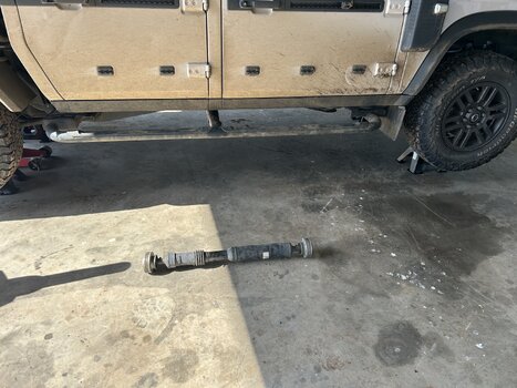

Having just joined the failed front shaft club, what are peoples opinions on some of these aftermarket shafts. Are they worth exploring, or am I better to just get the original fixed, and perhaps carry a spare cv?

Didn’t look too deep to be honest. Had felt a worsening vibration under load for a few days, and an obvious clicking in reverse. Inspection revealed a ruptured boot. I thought I’d rip it out to check it in isolation.
I will have a closer look when i get back to the shed.
I also removed it as I thought it would be easier to send the shaft back to Brisbane than the entire vehicle (we’re about 5.5 hours away)

Is your car lifted or stock? If you use your car a lot for offroad, I suggest to change the factory one. The factory CV boots just cannot handle more articulation from the front axel.
A small lift with the GVM increase - I think 35mm. Nearly all driving is on farm, so probably 80% dirt, but not a lot of technical stuff. Good advice though, I think I’ll look into some of the other options.

I would personally opt for just replacing the damaged CV itself. Here in the US the Terra Joint is cheap. If you can source them there then I would buy a spare or two as well.
You most likely only need to replace one joint and it's almost certainly the transfer case side. The diff side seems to hold up well.
