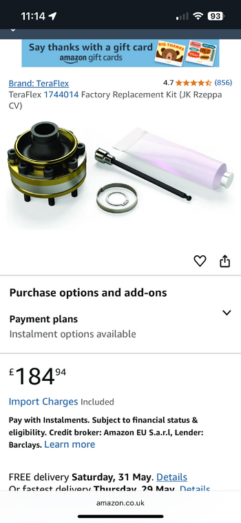

Can I ask - is the replacement Joint that Agile sell (
Teraflex Factory Replacement CV joint Kit – High Angle Rzeppa for Grenadier by Agile Offroad) a Jeep part that happens to fit our trucks? Or is it a specific Ineos one?​

Hi is this one. I’m thinking of getting a replacement to keep on board for travels. IMG_5657.png
