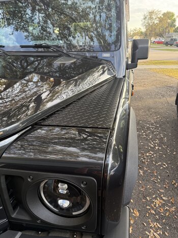

I purchased some diamond plates that will be held on with 3M strips. I waned OE but I thought I might give these a try. Fed Ex is due anytime, I'll post pic when installed.

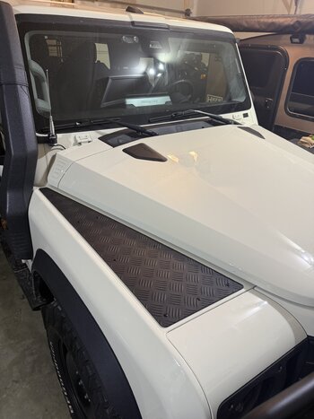

I'm not a fan of the checker plate look. I'm booked in to get PPF applied to the tops of the fenders. I want some scuff protection on those surfaces. I won't be standing on them but it's a handy work area.
