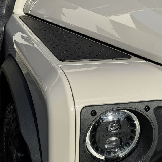

Just fitted Bison Gear fender plates with the supplied 3m adhesive tape. There is no way that’s coming off so rivets aren’t required. I was a bit hesitant at first. There are 3 pre drilled holes which needed filling in. So I purchased some 5mm plastic end caps, used a Stanley knife to reduce down to 3mm so it doesn’t poke out of the other side. Really happy with the quality of the fender plates, looks amazing and I can rest my cups of tea.

They look great. What are your thoughts on water and debris collecting between the plates and fender/wing?
Funny you should mention that. There are a couple of improvements that Bison could make. 1. Use black 3M adhesive tape instead of grey (I can see the grey tape underneath and looks unfinished). Therefore I have contemplated using a fine automotive black silicone to go around the edges (tucked inside just to hide the grey tape). However, my biggest concern is if water is trapped inside, how would it get out). 2. Alternatively maybe Bison should not of put the tape so close to the edges. I’m not concerned about rust, it’s aluminium. 3. Bison should include the plugs which I made up for those who don’t want to rivet.

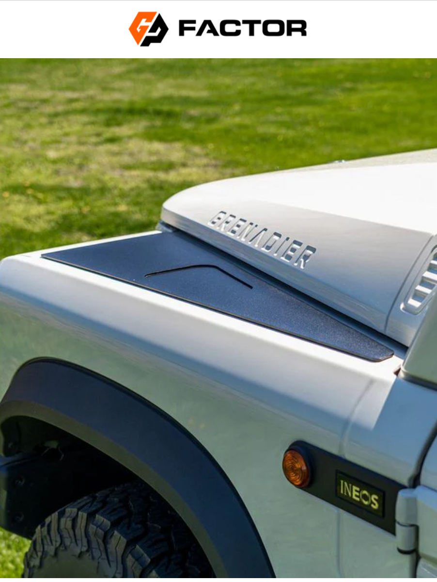

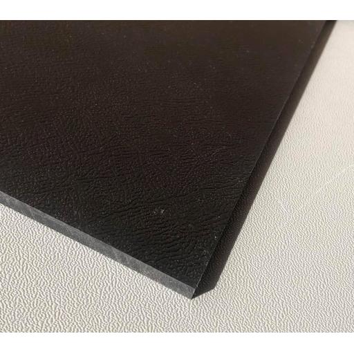

Hi, as a newbie EU Grenadier owner, I would like to add plastic or rubber black diamond-plates on my Scottish White fenders.
Anyone has got any experience in the meantime to share ?
Prefer to glue, not drill holes.
Thx, look forward to your responses.... 🤞
Hi there. The ones from Bison Gear in Poland look good for gluing;
I’ve have the Bison ones, I posted a while ago. They look great. I have them stuck on so far so good but there is a risk of the 3m tape delaminating in the centre due to rain water. The fenders warps in the centre with heat and cold. My advice is to prep the panel with alcohol spray they provide. Once stuck down, place something heavy in the centre of the plate overnight. Finally thin black silicone around edges to prevent dust and water. It will hold, never come off yet but if you want to be 100% sure, then rivet. I may give this a try in future.
