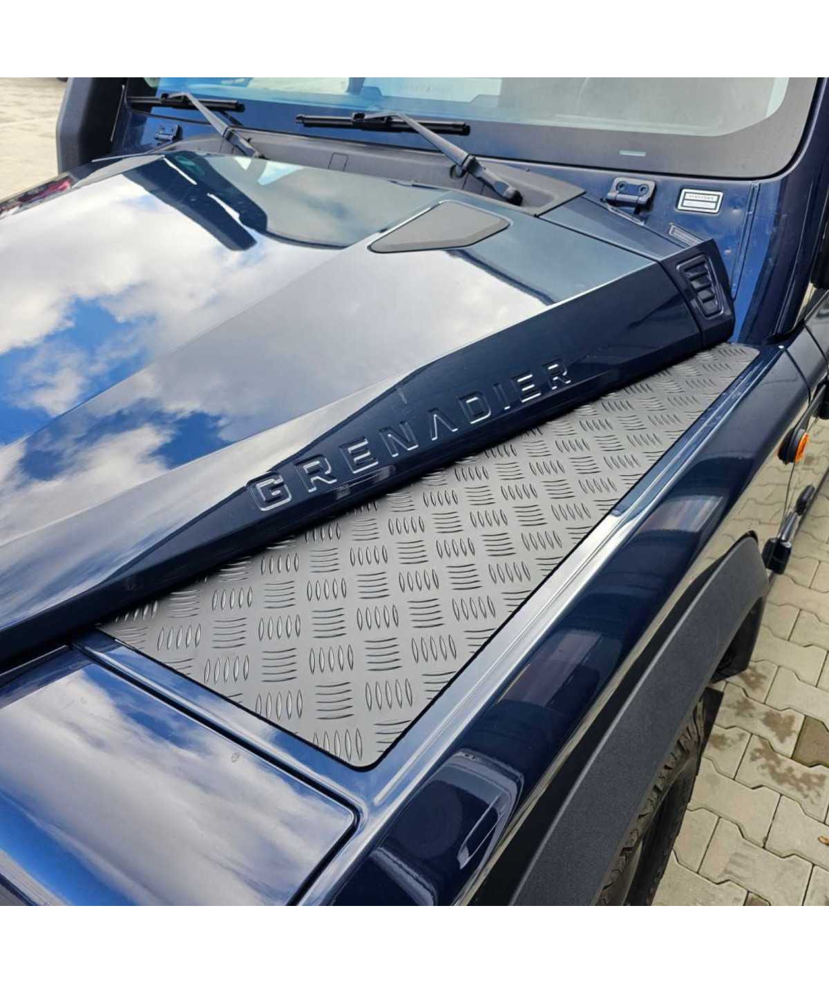

Hi there. The ones from Bison Gear in Poland look good for gluing;

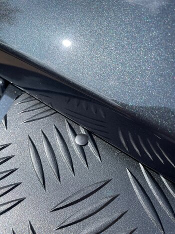

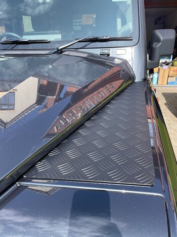

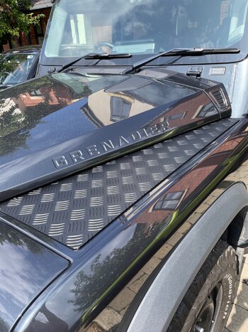

Bison in Poland make some good aluminium ones. Stuck on with 3M tape and black siliconed around the edges. Can rivet if you wish. Rivet is better but mine are stuck on and so far, after 2 years all is ok. Reason why I say rivet is better is because water will get behind hence why I siliconed. I plugged the pre drilled rivet holes with plastic caps.
Pros and cons of both ways but these are good quality and cheaper than OE.

Looks great and especially so because it's black/gray, mate!
I'm just going to have the dealer install the OEM ones with rivets while it's stuck there getting the HVAC "fixed". As shared, I like the silver riveted look which makes it look even tougher. lol
I live in Los Angeles so don't really have to worry about rust. Just being my normal OCD self.

It won’t rust. Everything including the rivets are aluminium. Silver rivets will last longer. With black rivets, the colour chips off eventually.
