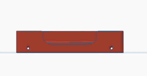

I printed a draft fast print to check how it fits. The original design opening for button access is pretty big, when I put my phone (iPhone 16) in the holder, the phone falls into the hole and rests on the big knob. But the holder fits the Grenadier USA handles fine.
I made the center hole a bit smaller, and 5mm higher to avoid the knob. I think access to the buttons will be fine and the phone won't fall in. I will print this one tonight and see what I think.
Do you have any use for those holes for elastic in the original design? If not I will plug them.

That looks great!!!
I don’t see a need for the string. In the full body one there’s a peg that the cord wraps around to hold the phone down. I don’t think that’s an issue.
A thought I had was to put a removable floor in that he phone w sit on to keep crap from falling down into the opening. Was thinking of just printing a plastic slab and covering it in grippy stuff.
