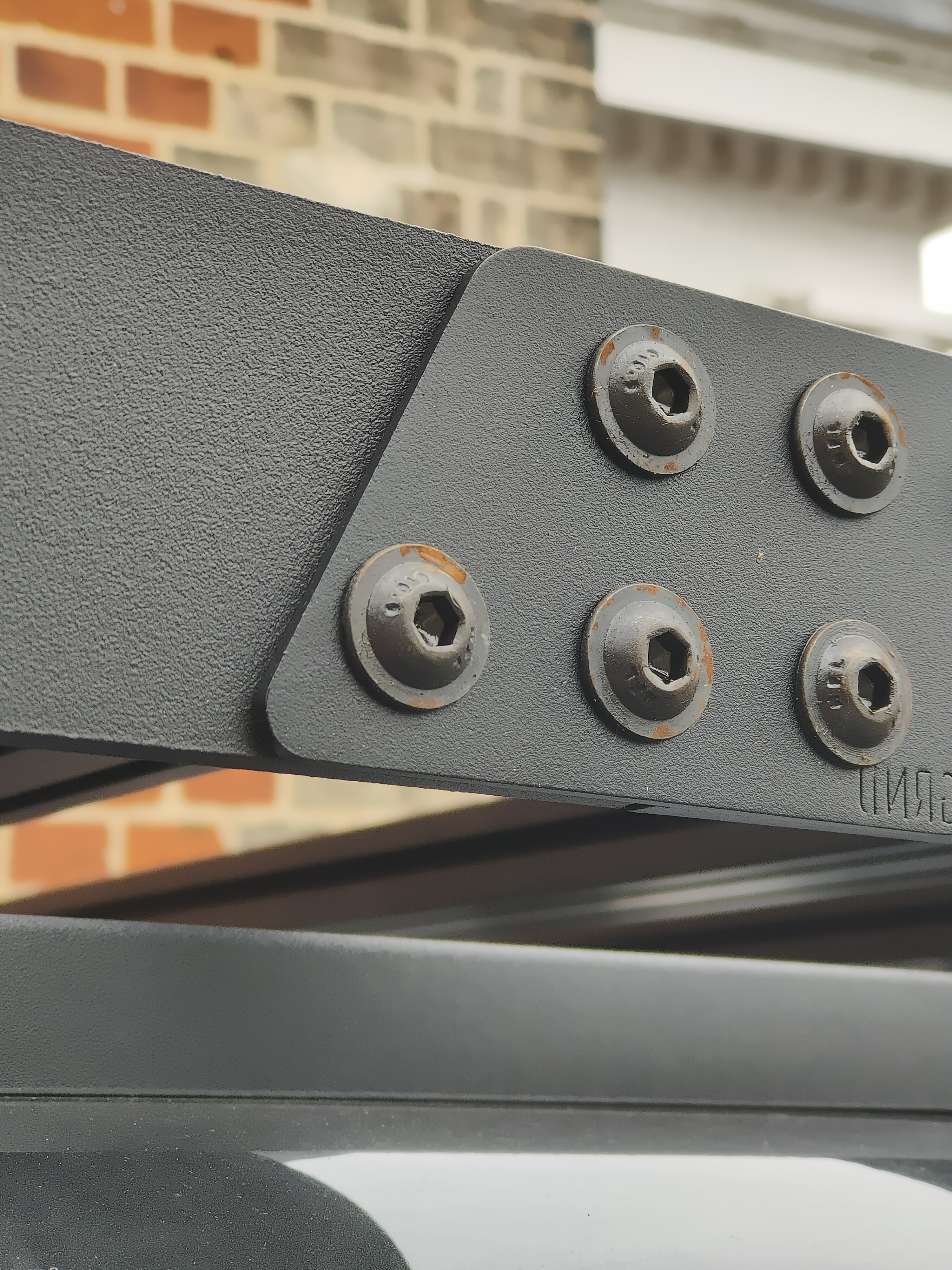

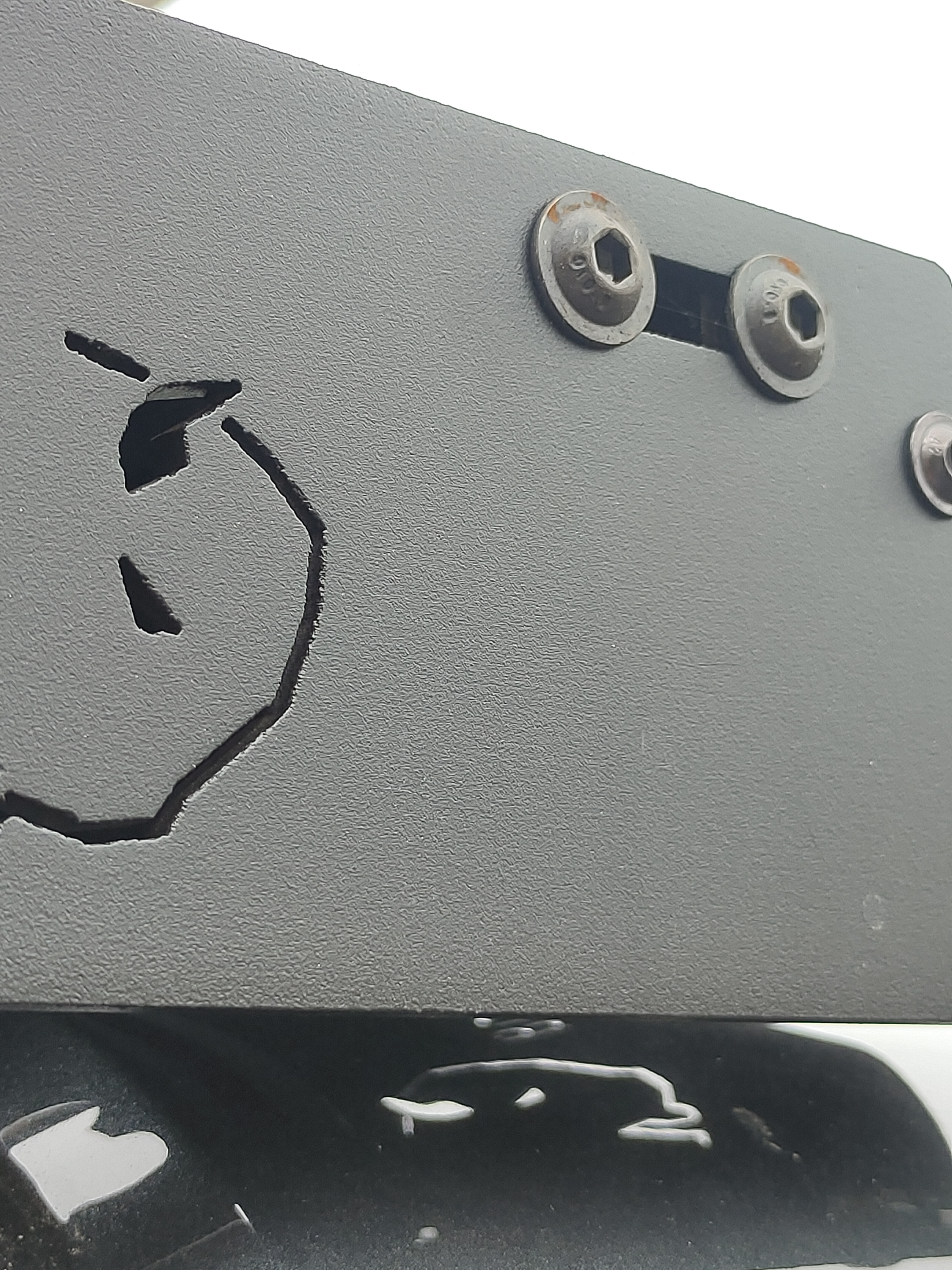

I have the Bison Gear 3/4 rack fitted and the factory supplied screws have started to rust . Perhaps the steel against the aluminium has caused this? Maybe I also need vinyl washers.
Black steel will rust quickly.
Even "Stainless" steel comes in several variants. Including "rusting" 🙂
Marine grade, from a ship chandlery is the safest option in my experience.
The best thing to do is remove the screws and put some Tef-Gel on the threads (one by one I would suggest)
Do you live somewhere near the sea? definitely worse if salt is around
Hi Grey Wolf, As recommended by others, get some Tef-Gel to stop dissimilar metals from having galvanic corrosion. It is pricy, however a little may last you a lifetime.
DaBull
DaBull
Thanks for the Amazon link. I have attached a couple of images. The rack is about 2 months old and it has been raining a lot here in the UK. 😞
