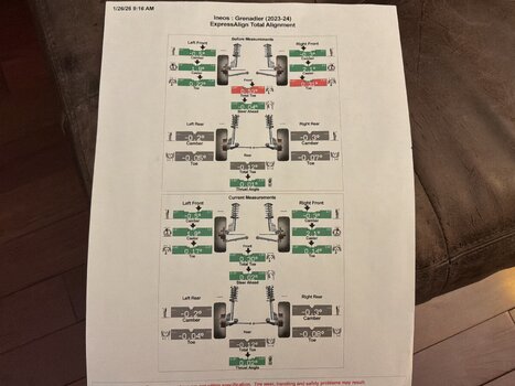

Since new, my IG has pulled left. A month ago it was aligned and steering wheel centered up. There was still a pull.
Today, I had the alignment checked and it was adjusted. Attached are the results. After driving, still a pull left and unfortunately, the steering wheel is off center again (tilts left).
I am wondering what you think? Should I seek out an independent shop?
I would start to look at tires and pressures now, alignment looks good.
Yes. That may be next. I am frustrated the steering wheel is off center once again. The tech adjusted the toe without resetting the drag link. It’s such a common procedure. I may need another dealer of 4x4 shop or go back to Crown Ineos in Columbus. I know Knauz is having service tech challenges. I love the vehicle regardless.
