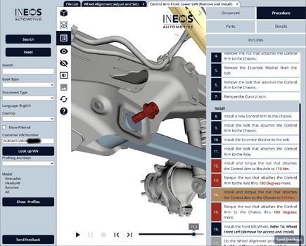

I've found what appears to be either conflicting or ambiguous information in the workshop manual regarding the torque specification for the front lower control arm bolt and nut.
LOWER CONTROL ARM - REMOVE AND REPLACE
The procedure for removing and replacing the front lower control arm is found at
Workshop Manual | Station Wagon and Utility Wagon | 4. Steering and Suspension |
4C. Front Suspension | Control arm Front Lower Left (Remove and Install)
This document includes the following instructions:
14. Install and torque the nut that attaches the Control Arm to the Chassis to 110 Nm.
15. Torque the nut that attaches the Control Arm to the Chassis thru
180 degrees more.

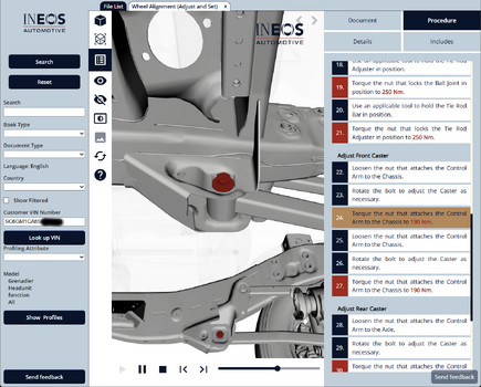

WHEEL ALIGNMENT
The procedure for aligning the front wheels is found at
4B. Steering | Wheel Alignment (Adjust and Set)
27. Torque the nut that attaches the Control Arm to the Chassis to 190 Nm.

The problem I see here is that the first procedure [110 Nm then 180° more] results in a far higher torque than 190 Nm. I had to use my impact wrench to achieve this spec . . . my WAG is it's in the 350 - 475 Nm range.
The only explanation I can think of is that the spec of [110 Nm then 180° more] might only be intended for the initial construction at the factory. The intent might be to compress the underlying steel structure ONE TIME with this procedure, then for every time thereafter - for the life of the vehicle - that the 190 Nm specification would apply.
I adjusted the caster on my vehicle recently and had only found the remove and replace procedure [110 Nm then 180° more], so my lower control arm fasteners are currently sitting at the amount of stretch resulting from that procedure. The bolt ought to be able to handle this amount of stretch without plastic deformation since the alignment procedure does not say to replace the bolt (a torque to yield bolt would need to be replaced any time the joint was loosened, e.g., during an alignment).
I'm inclined to remove the nut and bolt and inspect (with a micrometer) for necking that might indicate an overtorque condition, and if all is well, replace the fasteners and torque to 190 NM.
Any ideas on what Ineos intended here?

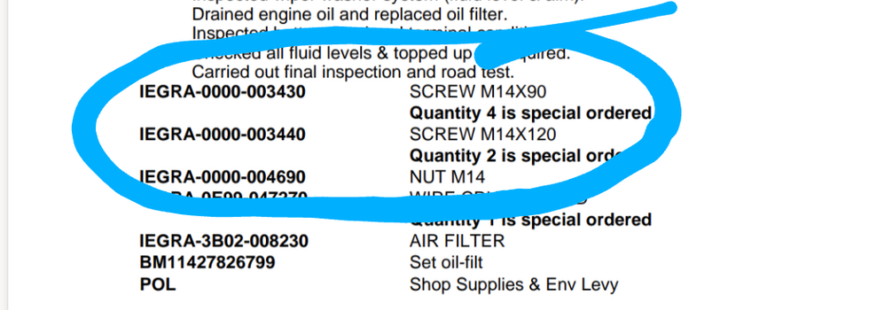

There was a torque check campaign on those bolts last year.
IAMWO002310-LONGITUDINAL ARM TORQUE CHK

I don't have it. I'm referencing the MWO # from a service invoice.
I posted a bit more about it here last August.
