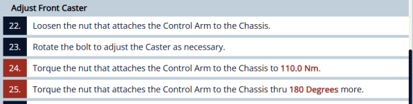

Ineos sent me an update today saying that they have verified the issue I identified is a problem and they are working to provide a resolution as quickly as possible.
In the interim, I found this post containing the same procedure of 110 Nm + 180° more. I presume this document presented was generated by Ineos engineers, but there is no certain attribution. I sure hope the 110 Nm + 180° procedure turns out to be wrong . . . by my investigation, that would mean the bolts need to be replaced every time they are loosened.
Glen, I like how you think.
Given the only way to adjust caster is to loosen the front lower control arm bolts it could suggest that any time an alignment is performed the control arm bolts need to be replaced. This is madness.
Ineos contacted me today to say their engineers are actively working to resolve the problem I described and they will notify me as soon as they achieve a resolution.
If it was a case of one or the other procedure is correct, you’d think the correct one would be quickly identified. So maybe this is a clue that neither procedure provides the intended outcome and they have to do some analysis of the joint to determine what’s required of the fastener. Hopefully . . . it could just be it’s problem #42 in the queue.

So the correct torque spec is 110 Nm + 180° additional rotation. The workshop manual appears to have been updated to remove the incorrect references to 190 Nm. The parts listing does not show the bolt as needing replacement and since the torque spec seems so close to the proof load of the fastener, I'll ask them to confirm the bolt is reuseable.

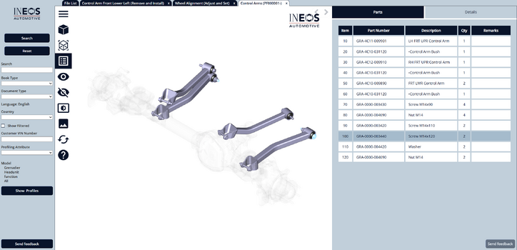

I wrote INEOS on March 12 and asked them to confirm the M14 bolt is REUSABLE. Here's what I wrote:
The parts listing does not designate the bolt in question (GRA-0000-003440) as single use for either the front or rear axle control arms. The confirmed torque spec of 110 Nm + 180° additional rotation seems to be very close to the proof load of a class 10.9 zinc plated M14 x 1.50 bolt. Can you confirm this part is intended to be reused?
An example of a part that is designated as single use is the propshaft screw set GRA-5D00-019750.
I figured I'd get a pretty quick answer since this information should have been considered long before now. Almost two weeks later - still no answer. That doesn't bode well . . . it makes me think someone said "Uh oh - we need to check this again."

So this situation is getting ridiculous. Here's the reply I received from Ineos today:
Following up on your enquiry, our Engineering team has confirmed that any bolt with a torque specification that includes an angle-tightening requirement should be considered single-use.
I hope this clarifies things. Please don’t hesitate to get in touch if you have any further questions or if there’s anything else we can assist you with.
Well no, it doesn't clarify things. Here's how I replied:
<start of email>
I appreciate your continued replies, but I don't think we're communicating effectively. I want to be clear about why I keep pressing this issue: I'm genuinely concerned about the safe operation of my own vehicle. If you and your team are unwilling to continue this conversation, please let me know and I'll stop pursuing the matter.
If you are willing to try to resolve the confusion, I'd ask that you pass these points along to your engineers for consideration.
1. The torque specification appears to drive the bolt far beyond yield.
The torque specification for part # GRA-0000-003440 (110 Nm + 180° advance) appears to take the bolt significantly past its yield point. Based on standard Class 10.9 calculations, yield occurs at approximately 110 Nm + 69° of advance. The specification calls for 180° of advance, which is approximately 2.6 times the angular advance required to reach yield. If the intent is a torque-to-yield procedure, driving the bolt 2.6× past the yield angle serves no engineering purpose and raises legitimate safety concerns. If the intent is not to yield the bolt, then the specification needs to be re-examined, because by any standard Class 10.9 analysis, that's what it does.
2. A torque-to-yield fastener on an adjustable suspension component is contradictory.
A torque-to-yield bolt is a single-use fastener – it must be replaced once it has been torqued to yield. Yet this bolt secures the control arm to the chassis and must be loosened and re-torqued each time the front caster is adjusted. The workshop manual (steps 22–25) reflects this contradiction directly:
There is no remove-and-replace instruction anywhere in this procedure. In practice, caster adjustment often requires multiple loosening and re-torquing cycles in a single session to dial in the correct geometry. If this is truly a torque-to-yield specification, the fastener would need to be replaced after each torquing cycle – which is neither stated in the manual nor operationally reasonable.
3. The Class 10.9 designation has published, well-understood properties – and none of your responses have addressed the apparent contradiction.
I understand that your engineers likely use sophisticated modelling software and may even have empirical test data. I'm not dismissing that. But the fastener is marked Class 10.9, and that designation carries defined mechanical properties under ISO 898-1 – yield strength, proof load, tensile stress area, and the relationships between applied torque, bolt tension, and angular advance under elastic and plastic deformation. These are not proprietary calculations; they are published standards that apply to any bolt of that specification regardless of manufacturer.
My concern is straightforward: under standard Class 10.9 analysis, your specification drives this bolt well past its elastic limit. None of the responses I've received so far have addressed that specific point. I'm not asking you to validate my calculations – I'm asking your engineers to re-examine (and if willing, to explain) how their specification is consistent with the known mechanical properties of a Class 10.9 fastener. If there's a reason this bolt behaves differently from what the standard predicts, I'd genuinely like to understand it.
I've attached a revised and more accurate version of the calculations that inform my concerns. A sensitivity analysis shows that across a wide range of reasonable input values – Young's modulus, thread friction coefficient (µ_t), nut bearing friction coefficient (µ_n), and effective bolt length – the bolt is driven well beyond yield when the current torque procedure is applied.
<end of email>

I noticed at my first realignment well over a year ago, when examining the parts used, the bolts were replaced.
I don’t believe the alignment procedure calls for a final tq until the end, but never the less, quite an odd design for something supposed to be field serviceable. I recall thinking I need to buy a few sets to keep in drawer. 🤷‍♂️
I just looked at this thread.
