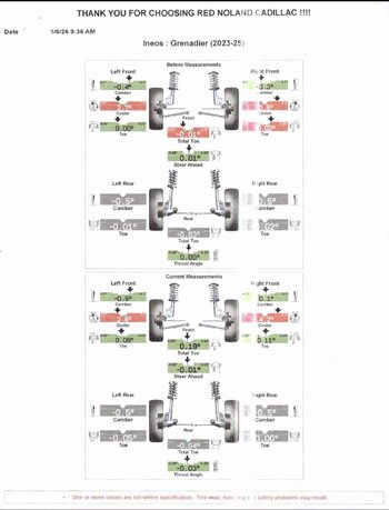

My vehicle has an annoying pull to the left. I noticed this after I installed new tires.
My dealer (very friendly people) checked my alignment… (see photo).
Left Caster is 2.8
Right castor is 4.2
My steering wheel needs to set about 10 to 15° clockwise for the vehicle to track straight, and I’m constantly “tugging” ok the steering wheel clockwise (to the right) regardless of the road crown.
I’m not sure if I understood my dealer correctly that castor cannot be directly adjusted??

I have my fourth follow up appointment now at the dealer, I don’t know how a 1.4° cross caster variance would result in anything other than the vehicle pulling… not at all a neutral steering experience!!
How do we know that those eccentrics are properly set if they’re not properly set is it expected that the result would be a caster variance?

You cannot adjust caster on each side independently. If one changes so does the other by exactly the same amount. If those are your real caster numbers then Ineos owes you a new front axle.
That spreadsheet with those caster numbers are with the Ineos dealwr here provided me with… they use their other dealership for their alignment system so not to be misleading. That is actually my vehicle. A 2024 Grenadier.
And in looking at the video, John did from OWL it would appear as though you could adjust one side and wouldn’t it have the opposite reaction to the other???
I am sure you are right, just wondering why the before showed a 1.2° difference and the after 1.4°?
Both sides adjust at the same time. When you adjust one side then the other you are just taking the preload out of the rubber bushings.
These trucks are solid axle, you cannot twist the axle. So whatever one side does so does the other.
Those caster angles don’t make any sense. As others have mentioned on a solid axle those measurements are in a fixed relationship left and right and would only differ by a small amount due to how the axle was jigged and assembled when built.
The adjustment cams will indeed adjust your caster settings (rotate the axle fore and aft) and it is possible for one cam to be positioned carelessly 180 degrees out from the other but that would only cause the axle thrust angle to be off meaning the centerline of the axle is no longer inline with the chassis centerline (crabbing) putting an uneven pre-load on all the control arm bushings.
Either the axle was built incorrectly, bent, or some other damage issue. Most likely the person doing the alignment was not very particular when setting up measuring heads on each wheel. I’ve seen and suffered from apprentice alignment techs just wrenching on adjustment cams but not having a full understanding of what impact it has on the overall setup as they chase measurements on the alignment machine screens. I’d take it somewhere else and compare their readings to the current ones you have.

The adjustable arms are a pain to adjust. The factory arms with cam bolts allow you to exceed max and min caster. You won't want to max out caster because that will work your drive shaft too hard. To little caster and you will be all over the road.
Point is the factory arms achieve everything you need.
The pulling is something else entirely. Take it to a regular alignment shop and get accurate numbers before you do anything else.
So are you suggesting that the factory arms/caster is adjustable?
Suggesting? No, they are factually adjustable. Your dealer should have done an alignment on the truck during PDI. This would include setting toe and caster along with centering steering wheel. The Ineos factory only has two alignment racks so they can't keep up. They ship the trucks unaligned and pay the dealerships to align.

There has to be a misunderstanding. This is really simple stuff. Take it back and demand they try again. Something is amiss on your truck and it could very well not be safe to drive.
Or as I said before take it to a shop that specializes in alignments. It will cost you about $150-200 but that's worth knowing for sure and maybe they can solve the problem. Then take the bill to Ineos and tell them to reimburse you.
Well, I spoke to my dealer today and again they are very, very friendly very friendly. I love them.
And they indeed confirmed they can adjust the caster … and the current setting is according to them set up to accommodate anticipated road crown … they explained that this castor would not affect pull (the current readings that you see in my post) …. Which again I’m not a suspension professional at all. I’m just trying to use as much research as I can online and from online research and AI research across castor condition like I have would indeed induce a pull to the left… again I’m not saying that this is or is not true. I’m simply saying that my AI content research from a variety of AI engines have all unanimously said it would indeed introduce a pull to the left given my values.
My dealer is willing to set that caster to neutral so I’m hoping that solves the problem we’re going to find out !!
Your dealer is not doing you any favors adjusting in compensations. Take the alignment specs below to an independent shop that understands live axle setups and compare your vehicle to the “Nominal” specs in the image below. Notice they are even side to side. They may not be able to get it perfect but the closer you are to those nominal specs the better. Throwing money at adjustable arms at this point is pointless until you know for sure you don’t have damage or issues preventing your rig from being set properly to stock specifications. There is plenty adjustability in the stock suspension (assuming you don’t have a lift or damage) to hit these targets.

The good news is I spoke to my dealer and they told me that they can in fact adjust the caster the reason they have it set the way they do is to accommodate anticipated road crown; and that that should not affect pull whatsoever
Which to me seems strange because all the research I’ve done suggest that that cross chamber split would indeed create Paul to the side that had the lower value
I’m not an expert here
So if my dealer is able to set that caster equally to both sides at zero, is that what you would request???
