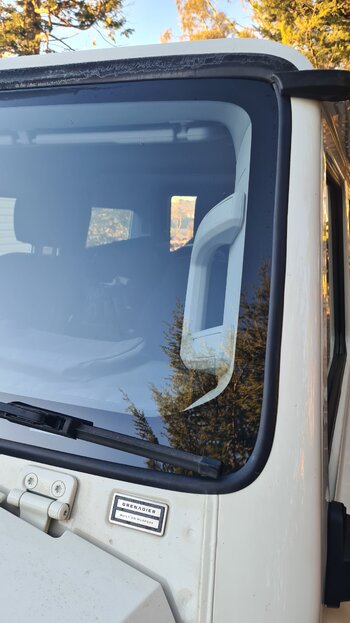

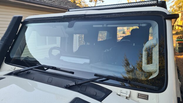

I finally had my windscreen replaced yesterday after a lengthy drama... In fact I had 2 windscreens, the 1st was installed by a regional installer specified by the insurance company against my advice and was a total stuff-up. Insurance then directed me to O'Brien AutoGlass Fyshwick in Canberra for it to be redone.
The first installer, apart from installing the glass crooked, the mirror crooked, scratching the glass, had also scratched the paintwork of the bottom edge of the window opening in several spots and even damaged the VIN sticker (also the creaking sound while driving at any speed was unbelievable). The tech at O'Brien Fyshwick did a great job with touch-up paint and then using a black weatherseal around the edge of the glass (similar to what has been discussed on this forum and Owl). He said it would help protect the edge of the glass from cracking, and had done this on Jeeps also. Looks good, almost better than OEM, no wind noise. The glass is non Ineos, branded as XYG.
This morning after -5C, no cracks!
