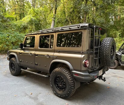

35 x 11.5 Toyo AT3 C load range. No lift. Turned wheel pics at full lock with steering stop adjusted to max (fully screwed in with retaining nut still on). So far so good. Steers easily with Fox stabilizer. No real change in acceleration or stopping compared to 285/70r17 tires. Spare clears small rear door with owl bracket. Wheels are 17x8 with 40 offset to provide a little poke compared to stock and easily clear suspension components.
Looks great. How is the ride quality and noise?
Looks so good! Is there a reason you went with that size over the 35x12.5 LT?
A few reasons. The main one is that they barely fit without rubbing on the stock suspension. I suspect the 12.5” wide would rub at full lock. The other is the on road driving characteristics of a narrower tire vs wide, although these are still relatively wide. The last reason was weight. These tires weigh 61 lbs and several of the 315s or 35x12 are pushing 70 lbs. My neighbor has this exact same brand / size on a Gladiator so I was able to also check them out before buying them.
Ride quality is great and basically the same as the 285/75r17 ko3s, but quieter. The toyos have less aggressive tread than the Ko3s and are quieter plus they weigh less for the same size and load range. I prefer the look of the ko3s, but am very happy with these from a performance and appearance standpoint.

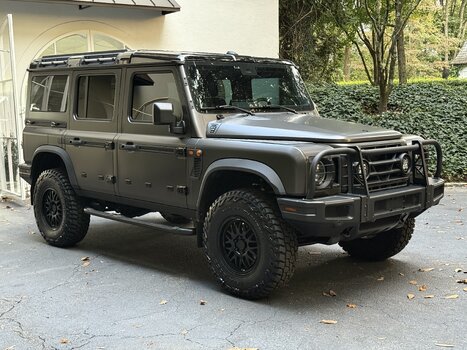

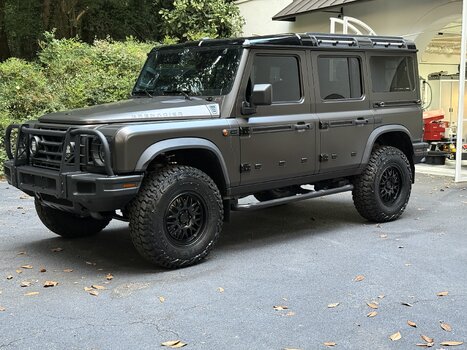

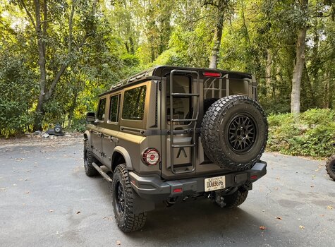

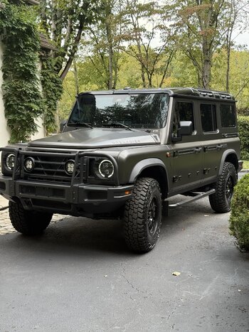

Finally got mine pretty much done. MT Baja boss 255/85 17. Titan7 forged wheels ET39. Eibach 2” lift, Radflo shocks.

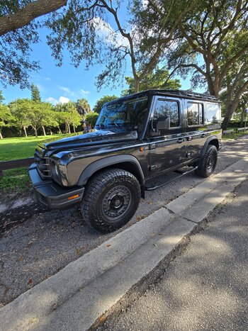

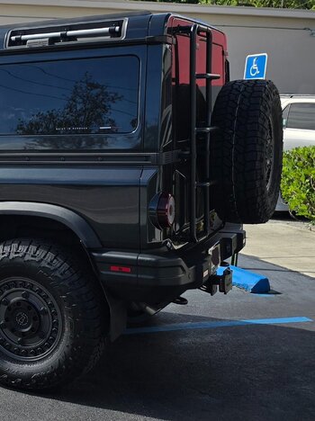

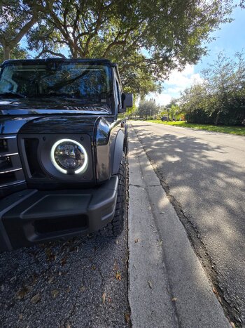

Hello! Tossed and turned for a bit on deciding whether to lift or not lift. Decided to remain stock height. Here goes:
17" black rhino Armory wheels (gun black, +38mm)
285/75 R17 Falken Wild Peaks A/T4 (10 ply)
Zero rubbing. Speed bumps, curb hopping, and mild offroading tested. (Disclaimer: live in flat florida).
On Stock size, speedometer was reading 2-3 miles and hour slower. (GPS verified).
New size 100% accurate up to 70mph. Above that, speedometer reads lower with difference increasing 1-2mph for every 7ish mph.

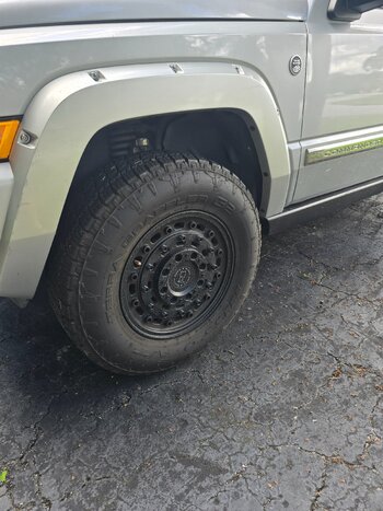

Black Rhino Armory wheels certainly have that distinct military style to them but essentially being closed face would be a touch concerned about airflow in and around the brakes. Certainly air finds its way around the inside of the wheel but could the shedding of water and mud under certain conditions be a concern? Asking, as I’m slowing narrowing in on a few wheel options for my own rig.
Great question. This is my first set of Armory wheels so I don't have the mud experience yet, but I also own a 2006 jeep commander(hemi, 4x4, limited) with BR arsenal wheels (similar) and that one I do have mud experience. Didn't have any issues at all. Granted, the arsenals have tiny holes in them, but pretty sure they aren't big enough to make a significant difference. (Pic of commander with BR arsenal attached for reference).

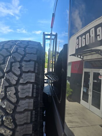

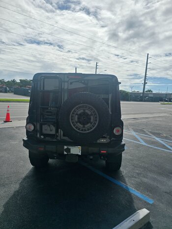

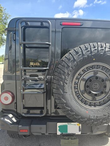

Update: wheel shop finally received 5th wheel.
Owlvan spare tire relocation bracket installed with Spare (definitely needed it). No spacers needed on bracket. See pics for details.
