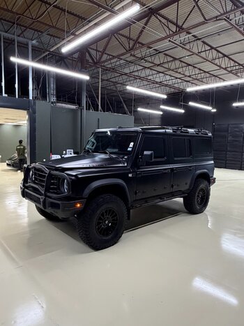

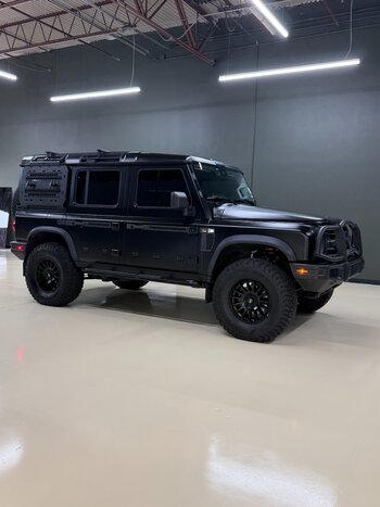

Yokohama Geolandar G003 M/T in 295/70/R17.
Black Rhino Arsenal on carbon metallic (custom powder coat), I bought a scratched set and had them redone).
Eibach 1.7" lift up front, eibach HD 500lbs in rear (about 1.4" lift).
Leitner relocation kit in the rear.
I think 33" tires is a real sweet spot for the Grenadier.
These tires works on my factory steel rims and this lift without any rubbing even at hard suspension compression.
How are you liking the Yokos? Def my favorite looking tires of all time. So aggressive and I hear they're quiet.
