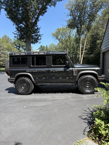

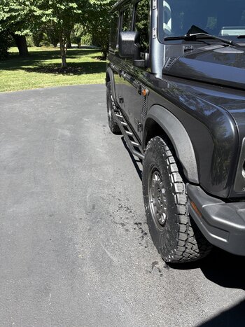

Switched to 17” steelies (Alcar 9007 built to OEM spec and TÜV certified) and Yokohama X-AT, 255/80r17. Took off the 18” steelies with Yokohama AT4, 275/70r18. The 18” steelies/AT4’s will become my winter/snow setup since they are 3-peak rated and the 17” steelies/X-AT’s are not.
Both are 33.3” diameter, but the 18” setup weighed 93lbs per wheel, the 17” weighs 83lbs. Saving me 10lbs per wheel of rotating and unsprung mass. I also wanted more sidewall and more aggressive tread for my trip to Moab in October.

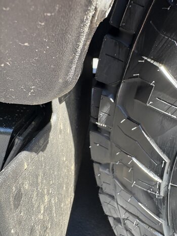

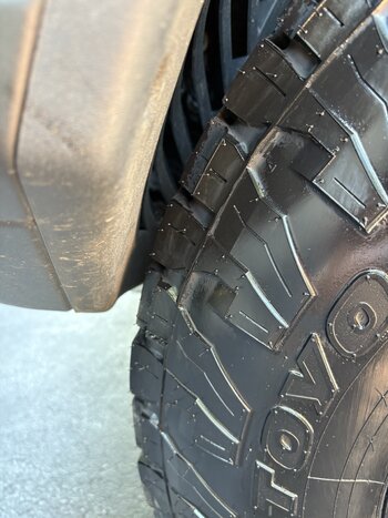

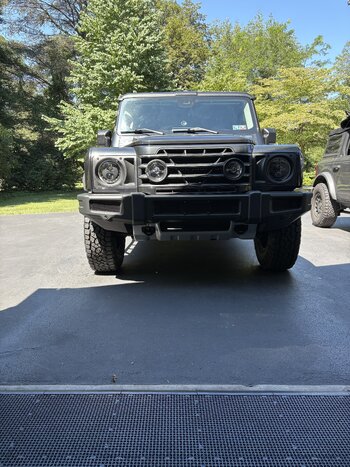

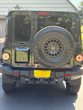

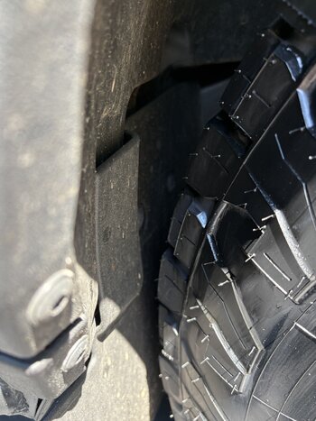

35 x 11.5 Toyo AT3 C load range. No lift. Turned wheel pics at full lock with steering stop adjusted to max (fully screwed in with retaining nut still on). So far so good. Steers easily with Fox stabilizer. No real change in acceleration or stopping compared to 285/70r17 tires. Spare clears small rear door with owl bracket. Wheels are 17x8 with 40 offset to provide a little poke compared to stock and easily clear suspension components.
which wheels are those?
That's a cool badge you got on there. What is that camel?
Love the setup. Could you share where to purchase the Grenadier/Camel decal?
