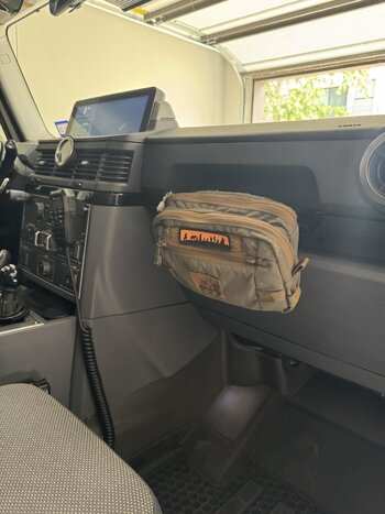

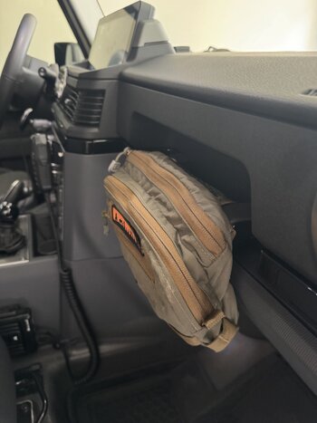

Who knew a fanny pack would make a great grab handle bag?! I took off the handle and it fit perfectly through the loop on the back. It’s a Kifaru Rogan pack if you’re interested.
