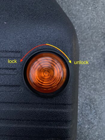

Therefore I looked in the portal how to dismount it. The first step is to dismount the side light, no further explanation, and when looking at the video, it looks like you should unscrew it "clockwise", quite unnatural. I tried it, but it didn't work. Anyway, you don't have any grip!
But, because it felt "unnatural" I went back to the portal. And instead of looking for the "snorkel" dismounting, I looked for the sidelight dismounting.
Indeed, it is anti-clockwise [EDITED: according to @Greasemonkey in the post below it is clockwise to release, I certainly should believe him! Because I still couldn't release the light from the snorkel] that it should be rotated. I tried it on the other sidelight, difficult, because no grip, but I succeeded:
Hello Jean!
I just tried it several times on my snorkel. To release it, I have to turn it clockwise. To fasten it, you have to turn it counterclockwise.
If you lightly grease the back of the light with silicone grease, you can turn it with your fingers. Alternatively, you could use the suction cup from a cell phone repair kit.
Hello Jean!
Well, well, well ... Thanks a lot for this: then the video is right! Thanks for the hint with the silicone grease. I will try it again, but not in the next two days, too much work
But, are you speaking of the light including the black ring around it, or only the orange light?
