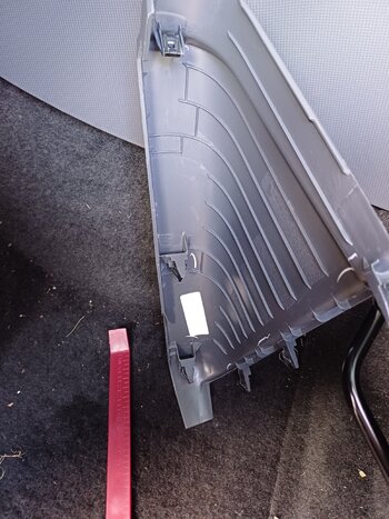

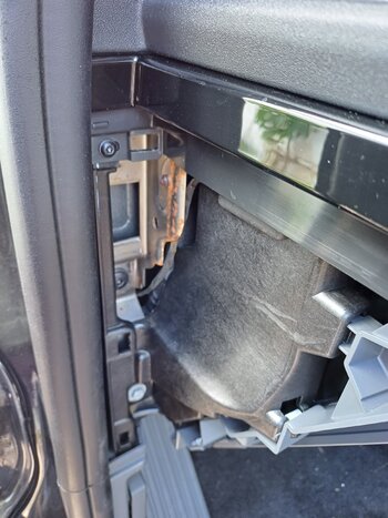

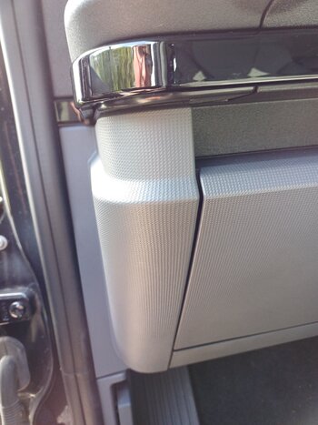

Pull the side panels off and check for tracking down the A frame. Look in the small "cups" in the plastic trim to see if there is any sign of water in them. If yes it is coming higher up, the safari roof seals. If it is the door seals it comes out the plastic trim at the bottom not on the carpet. It can also be the seal on the brake booster rod if on the drivers side.
