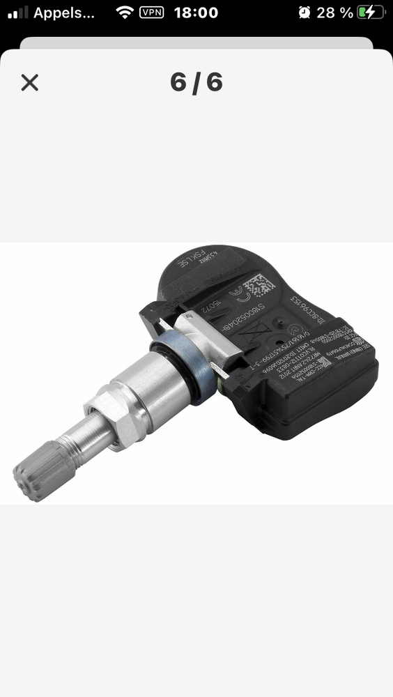

This is the tyre pressure and temp sensor part number GRA-4E00-019540
The GRA-4E00-019540 number I can't find in the Continental parts list. Is that part number an Ineos one or a manufacturers one.

Ineos part number
Ok. Just been quoted £1100 for 5x tpms incld VAT and tyre valves! That's about £900 more than I was expecting. I don't need a sensor telling me what psi I have. Nice but never needed it and can live without it. I air up/down at least twice a week. Not the agents fault but all I need is a work around - ie pull a fuse or something similar. My only concern when fitting new rims/tyres is I do not want a bing/bong/error. Welcome any thoughts. In meantime will email Continental and ask them what they have similar. Wonder if any sensor on same frequency will do the job or whether need a plug in computer to reset/delete the buggers.

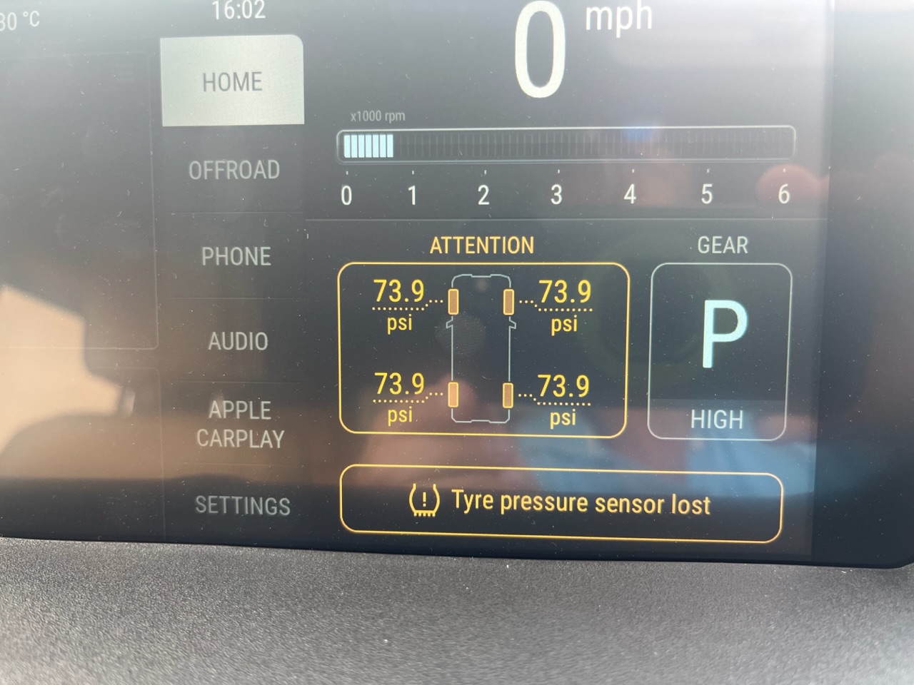

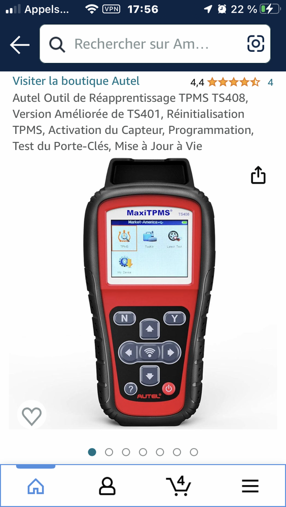

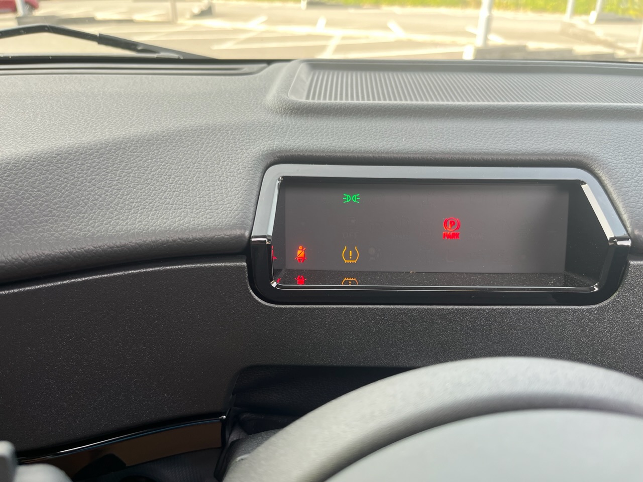

Anyone got a OBD TPMS tool that activates replacement sensors, something like the attached picture, I’ve fitted my second set of wheels (18x8.5 Evo Corse with 275/65 R18 Toyo’s) and the car can’t find the sensors?

Anyone got a OBD TPMS tool that activates replacement sensors, something like the attached picture, I’ve fitted my second set of wheels (28x8.5 Evo Corse with 275/65 R18 Toyo’s) and the car can’t find the sensors?
I'm still awaiting a fix. I too have fitted second set of wheels/tyres/sensors and the car cannot find them. I am still investigating. OBD tool to learn the new sensors or override them. I await more info.
