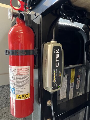

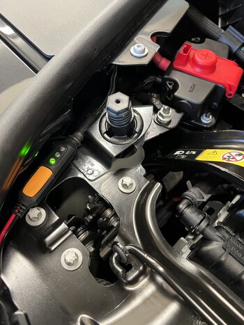

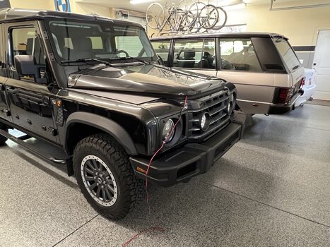

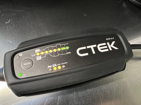

For a battery maintainer I went the CTEK route they really make it easy with their pre-fab pigtails for under the hood and cable extension kits. I attached the charger to a nearby workbench and plugged it into an integrated multi-outlet power strip so I can easily turn the charger off with one switch, disconnect the plug from the pigtail under the hood and hit the road.
I did put a black wiring loom on the pigtail to protect it and make it a bit more factory looking under the hood. Also, I’m sure I could have poked the pigtail through the grill or somewhere else to avoid lifting the hood but I didn’t like the idea of the plug being exposed directly to the elements or visible dangling through the grill or something similar.
