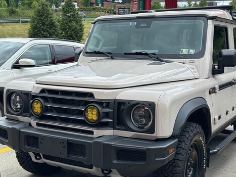

I posted this elsewhere but RDS installed this kit and mounted the magnetic hookup in the headlamp surround on the driver side (zoom to see). They wired directly to the battery did not go through jump points under hood. Very happy with it, I've been using this setup on a number of vehicles for years with good results. The kit from Hethel has adapters for whatever trickle charger you care to use (I have CTEK).
