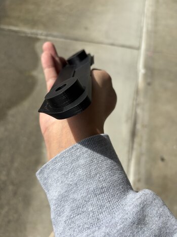

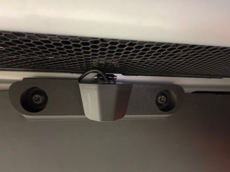

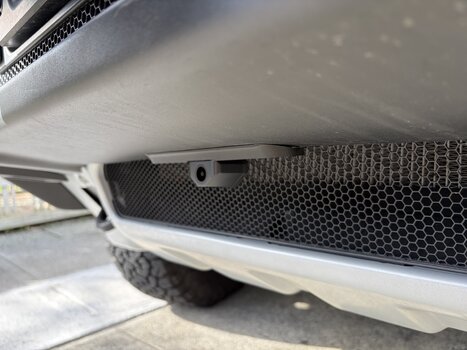

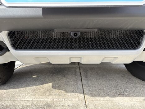

I mounted mine below the bumper. I 3D printed a bracket..
More details please. Are you pleased with it? How’s the view from that location? Did you compare it to the grill location? I still need to install my front but I’m trying to avoid the usual place.
Yes very pleased with it! I turned on the gridlines in the menu to have a point of reference when viewing,the closest line equivalent to 5ft. Sorry I cant compare to grill view, since I purposely avoided it. I wanted out of the way and least noticeable as possible.
Thank you. I may try this then. I’m horrible at printing stuff and think I can only do PLA.

How does it mount? Can you post some pics of the screws and the view from the mirror? Please let me know if you can print or at least upload the file. We would greatly appreciate it.
It mounts via the two existing screws on the bottom of the bumper, ill try to take some mirror views when im out and about…
