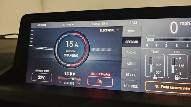

So I put it on trickle using the NOCO 10, AGM 12v, for a few hours. Disconnected, turned on ignition & went from 60% to 66%.
Started the car, drove to the local shop & back & the attached is showing 😬. Turned off, locked car, left it 5 mins and now showing 67%.

Yes unfortunately that’s happened to a few owners. This happened to me last year. First photo taken 1052hrs and the second at 1053hrs. Go figure that out. 😂. Hasn’t happened since. My vehicle is regularly left for days and sometimes weeks connected to a smart charger.
Happened to me yesterday! 70% then 0%, then the screen went blank!
Started ok and screen back on but none of the off road reading were available.
Put the MX10 on it when I got home (on main battery) two hours later fully charged :ROFLMAO:
