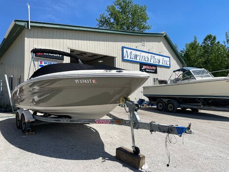

I'm looking at several low mileage 2024's. I don't mind adding what is needed as long as it will keep the vehicle safe when towing a boat. Availability could be ab issue on the components. I heard that the INEOS package includes a trailer sway module and stronger rear springs. I truly appreciate the input. I was headed to the dealership today to most likely make the purchase. However, this vehicle needs to be able to safely pull my boat.
This is the boat I will be pulling. 21 foot sea ray.
Rear springs are not part of the OEM tow option... My vehicle had the OEM tow package and still had the lightest rated rear springs
I own that identical boat... and living where I do (northern, hilly Vermont), there's no way I'd get a Grenadier without the factory hitch.
