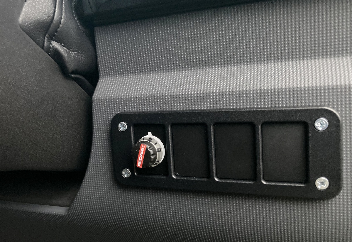

thanks Wombat. My Grenadier is going into the auto elec this week to get the Redarc Tow-Pro. where did you decide to put the control button? I haven't figured what to do about that.
See attached photo. The control button is located RHS of steering wheel as you can see, easy access if you are right handed. The actual Redarc brake control unit is located on the top inside edge of the trim panel below (blue marking). Brake signal from RHS rear trailer wiring is routed along the floor sill and up through the kick panel to the right and below the control button (next to the accelerator pedal). Positive power (when ignition turned on) comes from one of the spare fuse positions in the central fuse box under rear seat (also routed across the rear electrical compartment under the rear seat and along the RHS floor sill). There is a negative/earth bolt/nut somewhere behind the pedals I used for ground.
Another option is to put the Redarc controller in the same place, but mount it on a Lightforce switch panel, giving you extra options (if needed). More information here, with part numbers.
