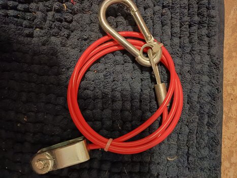

Too different operations, whilst US and Aus attachments are a secondary coupling to prevent detachment of a towed trailer/caravan. With an overrun braking system it is the opposite, if detached from the tow hitch, the overrun cable pulls on the handbrake tight bringing the trailer to a stop, then snaps to permit separation of vehicle and parked trailer.
For those NA and Aus members who haven't seen a UK and EU breakaway cable
