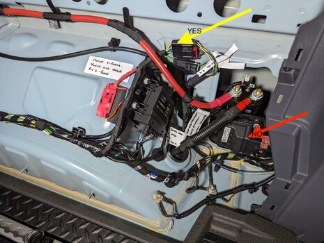

See @Clark Kent photo for the "live" wire. (attached)
At least on my truck, the "trailer module" brake wire is dead, both under the back seat and in the rear right corner at the black termination box. The 7 pin connector is live, everything is correct on the outside of the vehicle.
Splice into the brake lights before the loom connector (yellow arrow on clark's photo attached) and you should be good.
If you don't have a helper, jam a pice of wood between the brake pedal and the steering wheel, or seat, take a test light or multimeter and probe the (yellow arrow) connector for the hot pin to make sure you've got the correct wire.
Yes, it's all a PITA, but it's not difficult. You can do it!

For information, on my 25 quartermaster the wire with the yellow arrow in this photo is the brake signal wire position but my color is WHITE WITH AN ORANGE STRIPE. Also getting to the control module in the quartermaster is a huge pain in the ass. The rear seats have to come out and the plastic cover needs to be loosened and pulled back and its all fussy. Really pisses me off

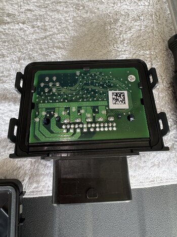

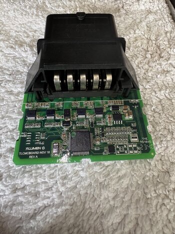

Ok - so finally got around to pulling the panels and getting ready for this project and thought I would share a bit more.
I found the blue/orange and violet/orange coming out of the TRM plug. I noticed the module had covers so figured I’d pull it apart and see why what inside.
I have attached some pics. As you can see - it’s a circuit board with a number of chips. My guess is that the board just needs to be replaced and we could all avoid the splicing game and be able to use the pre-wiring.
Anyone know if the ‘25 or ‘26 model years have this fixed? If so - could be as simple as getting the new TRM and just swapping it out?
