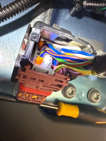

I have more wires in that Brake module and several are blue orange. I wonder if mine is working. And i don’t have to tap into it?
Can’t get that last black cap off. Looks like i have a dark blue orange and a light blue orange.
I have confirmed that this violet and orange wire is the one under the seat and i found a good spot to splice the violet/orange into the light blue/orange which is also the fourth wire just like the other people but a little unhappy that my other wires are different colors then yours but getting ready to take the leap of faith. Could not get 12V on my under seat wire when i pushed the brake so i am going to assume i have the same issue. Sort of annoyed that the dealer basically said they don’t install brake controllers.

Mine was like yours. No 12v when brake pressed. Added wire run from rear passenger harness and diode. I was a little confused with multiple similar wires. 12v light meter helped. Ran the one that lit when brake pressed.
Where you able to stick that in the harness or where did you test ? Currently that harness is open and i traced that fourth wire back in the harness to where i can get to it easier for jumping.

I pierced wires or used the end-of-lead into the harness area, if accessible.
I was sort of nervous to just start piercing wire but i did that. My multimeter has some attachments that are very sharp. Glad i did. The blue orange wire i was going to tie into did not produce any current. I tried another and got 12.4 volts when i press brake pedal so i will tie into that one. I suppose you just tape over your pierced wires? Maybe i misunderstood putting small hole on wire but it made sense. Was thinking of finding something smaller like a sewing needle but i use the sharp multi tester.

Tape the area is perfectly acceptable. You did exactly what I did, I chose the wrong one first, then got right one!
