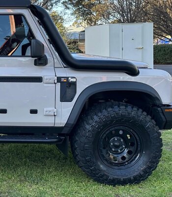

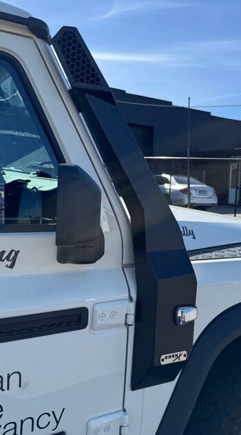

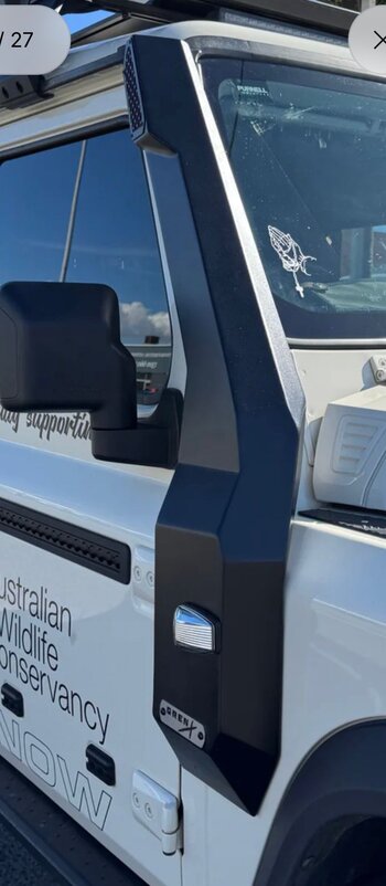

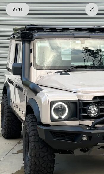

So I pulled the trigger on the GrenX snorkel. Hard price pill to swallow for an insurance policy for my trips in the high country, but seems no other viable options at the moment.
What is everyone’ view of which design is best? I am leaning towards the OEM look as it requires no fender cutting and looks OEM.
Are there any advantages or disadvantages in one design over the other?

Personally I like the OEM design. Not cutting into the vehicle bodywork is a major bonus for me. Also I’m not a great lover of the forward facing raised air intakes. It would be a concern to me that going 70mph in driving rain , that I would be forcing water down the intake.

I like the round tube, tucked against, and slightly above the wing. That one is stainless also.
I like the snorkel. It’s not really fully usable on a modern electronic engine, mostly wading insurance and of course good in dusty environments. So for me it’s a huge chunk of change and I worry about induction noise for the passenger.

I think the OEM style looks a bit more more subtle. I wonder what it would look like body coloured?

My preference was for the OEM styled variant. I believe this variant is also a bit quieter.

I went OEM because of no fender cutting, it just replaces the OEM. Plus I can reinstall the OEM RAI back.
Witrh the rear facing teardrop model the induction noise is MUCH louder than the OEM style snorkel. I have the OEM style on my car and I drove Rohan's car with the teardrop style. The snorkel opening is right near the driver's head and if the window is open, the increased induction is noticeable. Some people like induction noise, but not me.
The OEM Style is louder than the INEOS RAI, because the OEM Style snorkel is drawing its air from the opening, not multiple places like the INEOS RAI.

The OEM style snorkel is not that much louder than the INEOS RAI. It is a noticeable increase but I have no issues with the window down. The teardrop model IS much louder. I found myself leaving the window up.
The third style GrenX ramhead snorkel is probably between these two in noise, but I have not driven a car with it fitted. I have driven a car with INEOS RAI, GrenX OEM style snorkel and the GrenX teardrop snorkel.
EDIT: my GrenX snorkel is plumbed into the OEM airbox, while diesel owners wait for the new sealed airbox. So noise levels may change, once that is fitted. My car is a diesel and RHD, meaning the snorkel is on the driver's side.
