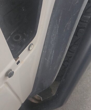

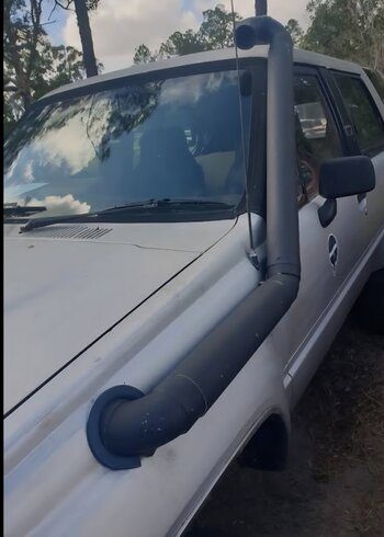

The RAI has two advantages over no intake, besides the air being drawn from a higher position.
The snorkel has a raised lip that loosely fits into the fender opening (top arrow). Second, around the raised lip is a seal, not a great seal, but better than no seal (bottom arrow).
So the odds of the cars with a RAI were better than the one with no intake, when crossing that river. But I would not have crossed that river at that depth with the OEM RAI, period.

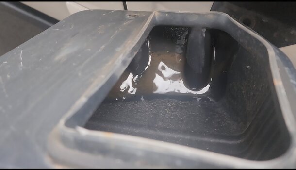

I removed my RAI a while ago, found water sitting in the bottom of it, it collects and holds it quite well, the section that is on the vehicle side has a "duck bill" valve to allow water to drain out. What I did notice is that that part is not sealed against the inside of the guard, so any attempt to seal the RAI from the outside is futile as it will leak from behind.

The opening grille at the top is just a few cm away from the gutter capping. I've watched water enter the RAI from the gutter overflow while washing my vehicle. It's not a stretch to imagine rainwater pooling in the RAI and bottom of the air box if you're travelling in the tropics and get a good downpour overnight. The drain valve should take care of it.
A pre filter sock might be good for more than just dust.
