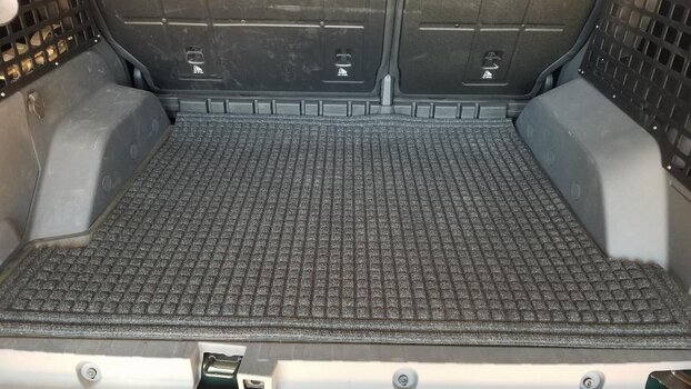

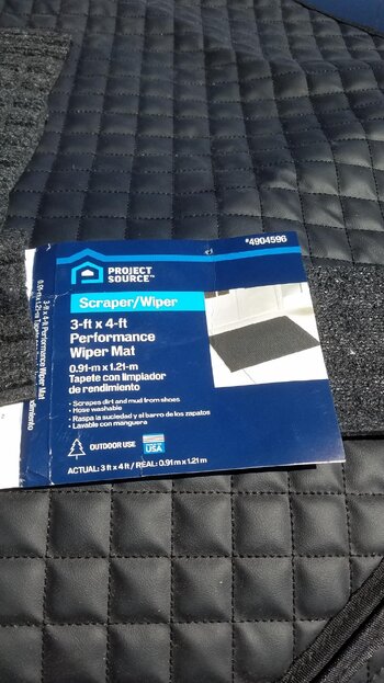

I am still going thru all the post on mods etc. I have been looking for a pad for the rear cargo area. I was looking for a bedrug to cut to find since I really like their products and
have them in my trucks and jeep. Since I haven't lucked out find one I bought this one
from amazon.
Cargo Mat Compatible with INEOS Grenadier 2020-2024 Accessories, Customized Specialized Trunk Mat, All Weather Protector Rear Cargo Mat, Waterproof Cargo Liner Trunk Mat, Non Slip Backing​
it actually work good but I still wanted a bedrug. I saw this cut down in some other website and went to lowe's and it is sort of close to the bed rug and cheap so I bought one and am trying
it out to see if I like it.

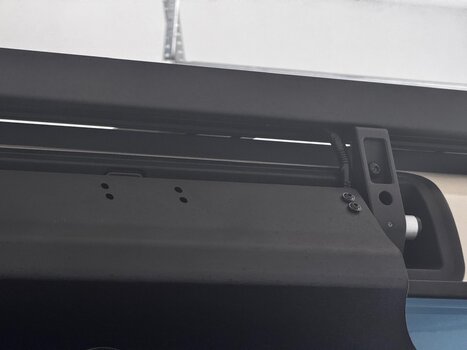

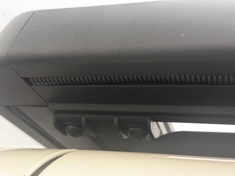

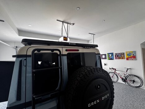

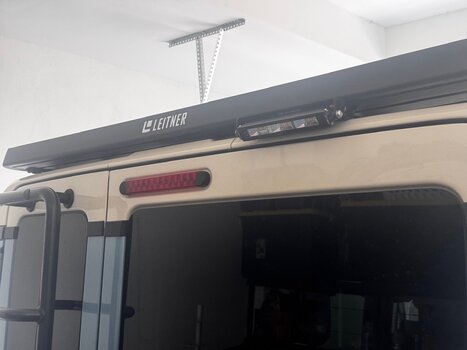

I am in the process of installing Stedi work flights on my Leither rack. They are made in Australia. I've been looking at many different options and these did everything I wanted: Strong light for setting up camp, dimmable with a very soft / low light feature keeping bugs away, white and/or amber color, stealth install, high quality/long lasting, reputable brand.
I chose the Micro touch v2 7.8" model. They have a set of white and orange LEDs embedded. You can turn them both on, just one or just the other. The colors are individually dimmable, and they remember their last setting. Stedi USA does not carry these versions in the US for some reason so I ordered from stedi UK website. No problems and arrived in the US in a few days via DHL. Paired them with steed steel roof rack brackets.
The lights are very well made, they feel solid, casing is metal, and the brackets are super solid steel. I had a hard time cutting through them with a metal bit on the drummer as I needed to modify the depth for the side of the Leitner rack.
I used Leitner bolts to mount to the underside of the rack. That is absolutely the way to go, and much easier to manage than the tabs that come with the lights themselves. Super easy to install and super secure. The lights from pre-wired with deutsch plugs, and I zip tied that to the underside of the bracket behind the light so you cannot see it. The wires then route up into the track in the rack, inside a 1/2" plastic sheathing that pops in and stays stuck. Very neat and tidy finish.
I mounted the side lights today after some head scratching and planning. Tomorrow, when my second set of brackets come, I will mount the third / rear light and tie them all together and terminate at one of the rear deutsch plugs in the roof of the grenadier (I order some connectors from Agile off-road as we'll as a crimping tool). the lights will be operated from inside. I will follow up when complete. I am very happy with the quality, value and install process so far. the lights are are about $70 each and the brackets are 2-for-$55 or so.
View: https://www.youtube.com/watch?v=VNN7bfDz438
Finished up the install. Wires all routed in the internal tracks in the leitner rack. Used 3/8” plastic conduit and it fits perfect.
Happy with the outcome. Lights are awesome I keep the rear on high /white+orange for reversing and sides low orange only.
Switched via overhead panel.

That's very tidy. Nicely done 🍻

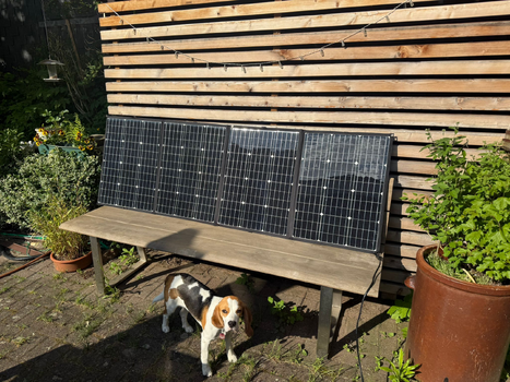

Bought at Amazon Warehouse Deal (133€)240W foldable Solarpanel, with MPPT and lot of different connections. Direct connection under bonnet charge up to 20A .
Works well, OK the MPPT will be changed in time to Victron, but for me fast and good solution, to be more than 2 Days independent…..

Pecrfect. That same setup works for me also. I have 2 x 100w foldable panels and I can survive with that inc running a fridge

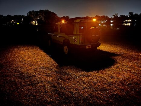

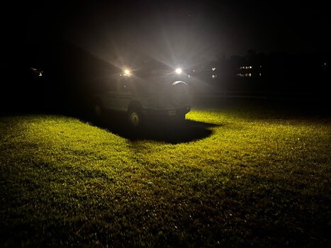

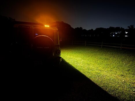

Finally got back from travel and was able to test out the Stedi lights tonight now that I got them wired up.
I think this is the best option on the market. Bright White and/or soft white/orange. Colors can be activated independently or together for maximum output. Each color is dimmable independently. Each light is independently controlled. Very low draw. All triggered via overhead switch. Stealth install.
Very happy. On the orange/lowest setting it’s a very gentle evening light once camp is setup. You can turn them on high for when you need a lot of light when setting up camp.
I’m a fan now. Not sure why other manufacturers don’t equip lights with dimmers… makes this very versatile

Triggered by the overhead switch but how do you control the color and dimming function? Looks good. The orange/yellow light definitely helps attract less bugs in the summer🤙🏻🤙🏻

I have these too and can confirm they are awesome 😎
