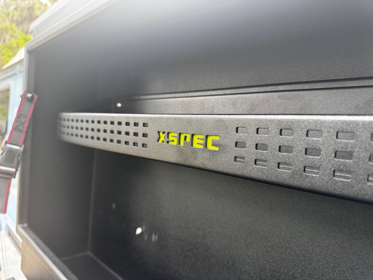

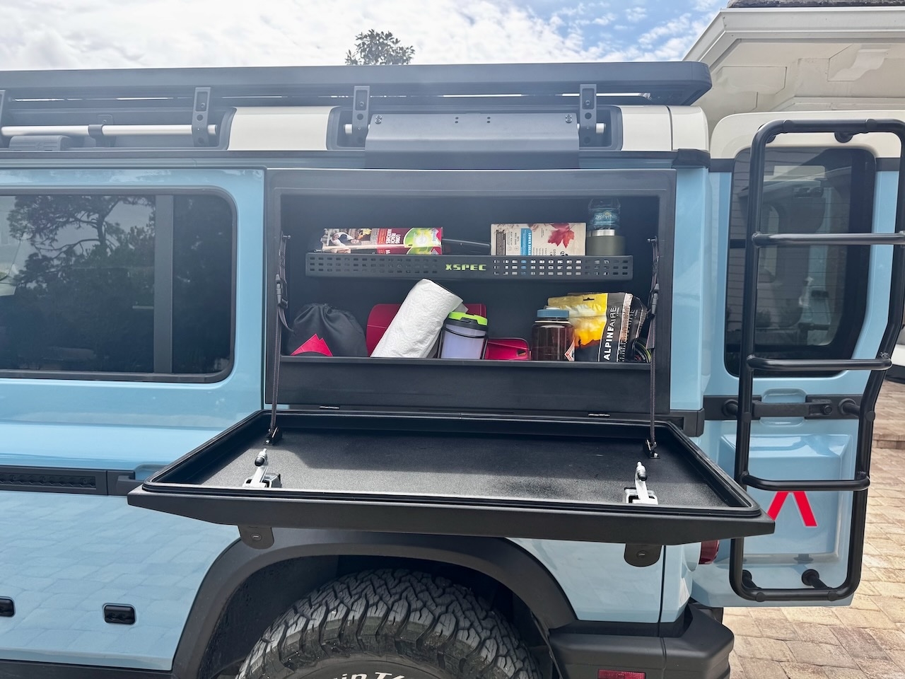

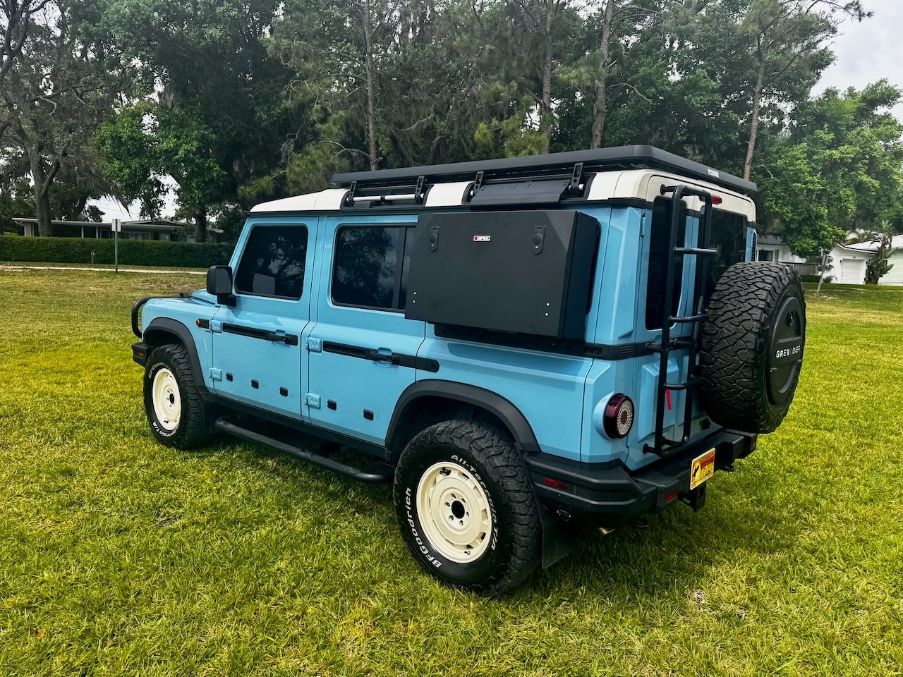

Received and Installed some kit from XHQ this weekend. Top notch products! I was really after their pantry system for camping, as it was becoming cumbersome to dig through storage bags to get after food and cooking gear. I ordered 2 XFrames, large pantry and a vaast water canister with gravity faucet.
I couldn't be happier now. Top notch gear and exceptional customer service and communications.
The pantry came equipped with gas struts attached to the door. I felt they were overkill really, and so I replaced those with some basic adjustable nylon straps so I can level the door / use as a table when open. Shipping to the United States via DHL was hassle free and the step-by-step notifications from DHL were great. I paid $100 in duty to import.
Here are some photos. Thanks again XHQ...

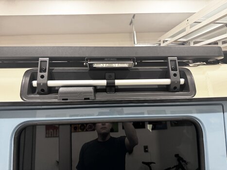

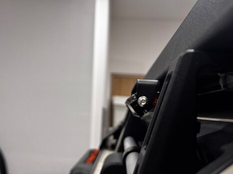

I am in the process of installing Stedi work flights on my Leither rack. They are made in Australia. I've been looking at many different options and these did everything I wanted: Strong light for setting up camp, dimmable with a very soft / low light feature keeping bugs away, white and/or amber color, stealth install, high quality/long lasting, reputable brand.
I chose the Micro touch v2 7.8" model. They have a set of white and orange LEDs embedded. You can turn them both on, just one or just the other. The colors are individually dimmable, and they remember their last setting. Stedi USA does not carry these versions in the US for some reason so I ordered from stedi UK website. No problems and arrived in the US in a few days via DHL. Paired them with steed steel roof rack brackets.
The lights are very well made, they feel solid, casing is metal, and the brackets are super solid steel. I had a hard time cutting through them with a metal bit on the drummer as I needed to modify the depth for the side of the Leitner rack.
I used Leitner bolts to mount to the underside of the rack. That is absolutely the way to go, and much easier to manage than the tabs that come with the lights themselves. Super easy to install and super secure. The lights from pre-wired with deutsch plugs, and I zip tied that to the underside of the bracket behind the light so you cannot see it. The wires then route up into the track in the rack, inside a 1/2" plastic sheathing that pops in and stays stuck. Very neat and tidy finish.
I mounted the side lights today after some head scratching and planning. Tomorrow, when my second set of brackets come, I will mount the third / rear light and tie them all together and terminate at one of the rear deutsch plugs in the roof of the grenadier (I order some connectors from Agile off-road as we'll as a crimping tool). the lights will be operated from inside. I will follow up when complete. I am very happy with the quality, value and install process so far. the lights are are about $70 each and the brackets are 2-for-$55 or so.

Did you order from the UK? I had to change countries on my VPN to see the dual color because I kept getting redirected to the US site. Don't know why they are not offered in the US. Wanted to go with those, but went with the C4 LED cubes with the amber lenses on.
Never mind - I see now you did order from the UK site.
Yes - if you try to go to stedi Australia website they re-direct to the US website. I found the work around to be the UK web store, which allows you to order and ship to the US :)
It's a very simple 'modification', but very effective at helping to avoid any slippage on the rear ladder. I bought a roll of 50mm x 10m anti-slip abrasive tape on ebay for £13, cut individual pieces to size, and stuck them on. I've used this on rock sliders on my other 4x4 and it's hard wearing and lasts for ages. As/when it wears down to the point that you want to replace it, it's easy to simply peel off and renew.
I also ordered the Stedi Micro Touch lights. They're perfect for this implementation and no one else seems to be making anything similar.
As mentioned, the AU site redirects to the US site where the lights are not listed. I didn't think about checking other localized web stores, but did find that if you email them with your address and SKUs you'd like to order they'll send an invoice and ship from Aus. When asked, the rep said they're building out the US store, but it may take a while to reach parity.
