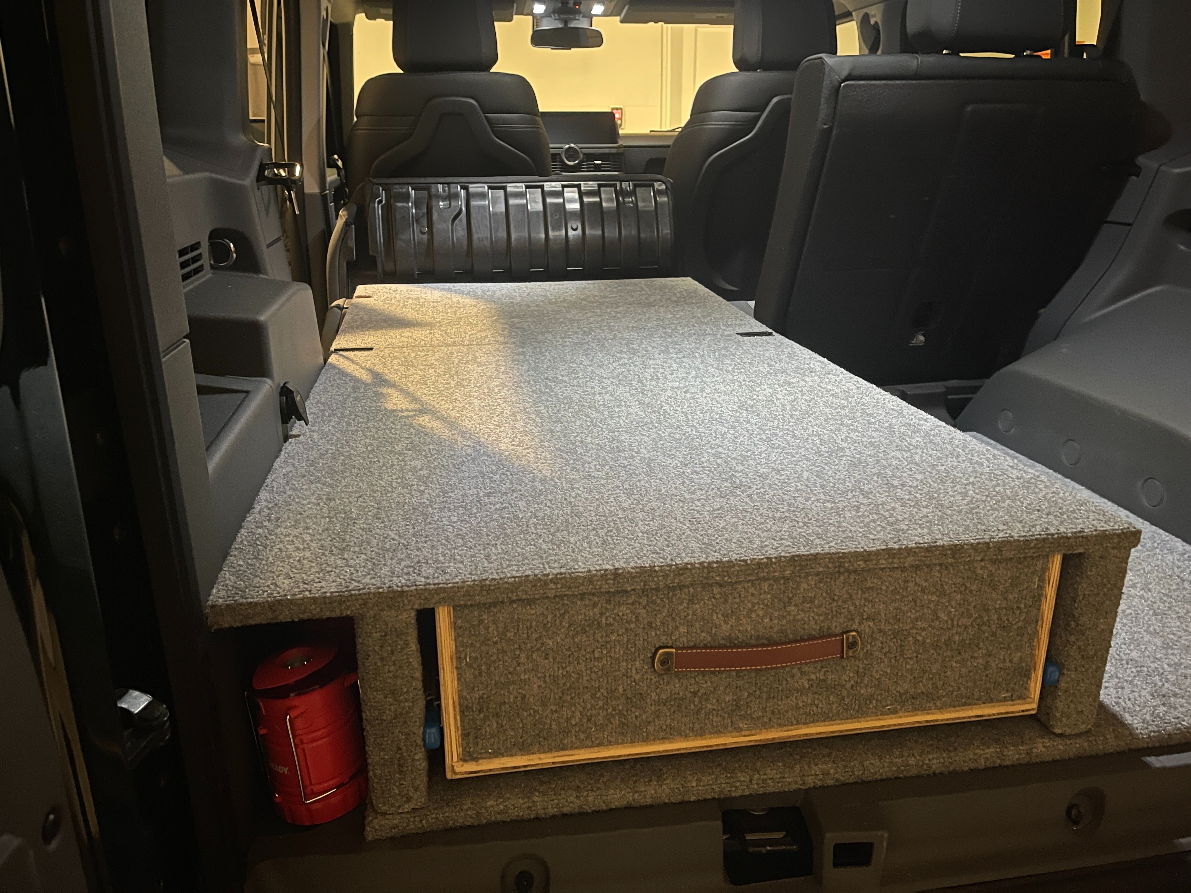

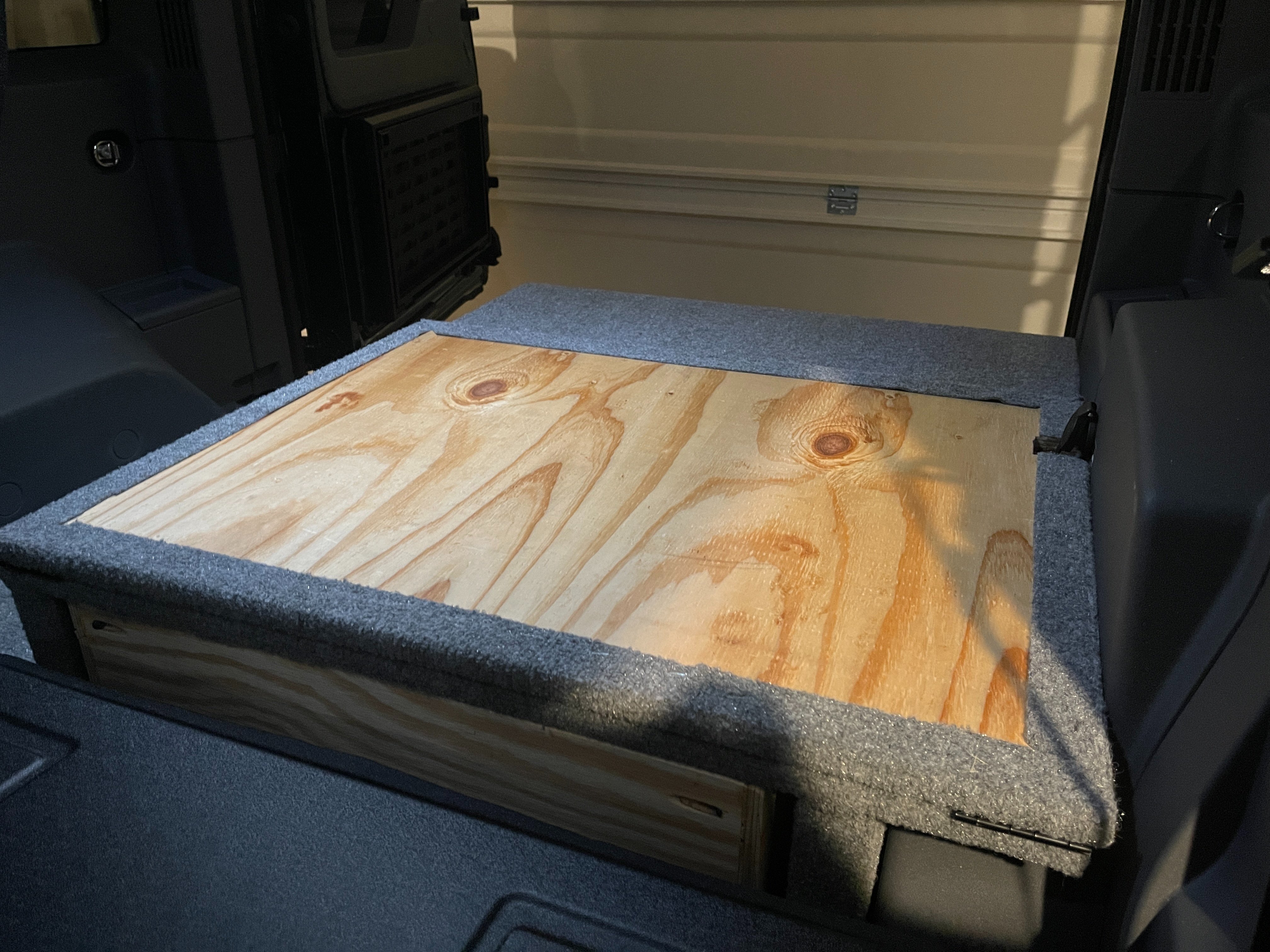

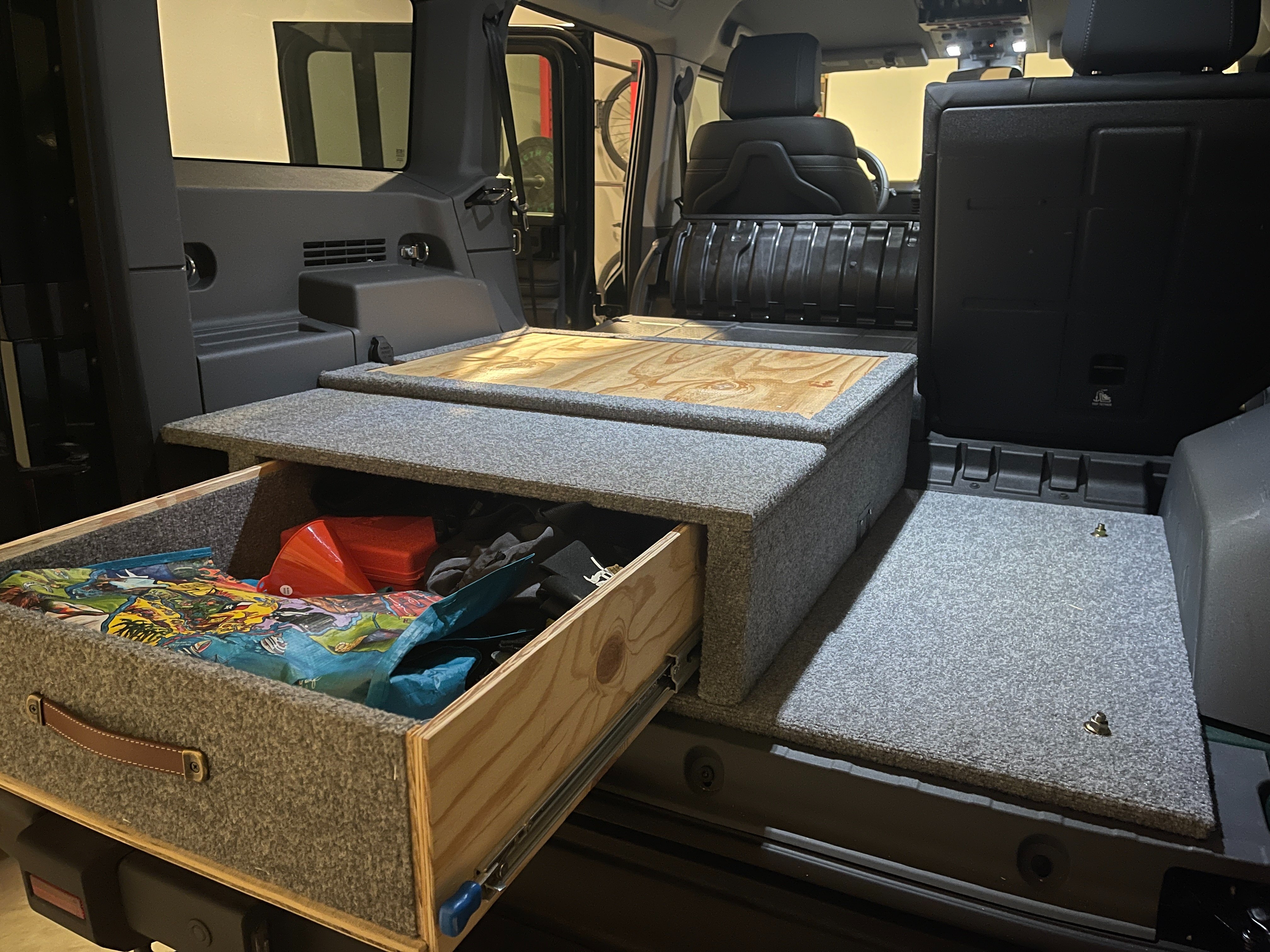

A DIY sleeping platform/storage solution ive been slowly working on over the past few weeks. Not finished yet, but coming along nicely, especially for not knowing much about woodworking before attempting this :LOL:
Next step is to build the drawer...
Figured I would post an update now that I've finished this little project. Nothing fancy, but works for what I will use it for (until I inevitably fall into the trap of buying a rooftop tent... :ROFLMAO:) and was much cheaper than the aftermarket solutions out there.
The drawer sticks a little, but if I pull hard enough I don't notice it. Might add some sort of material on the back of the top panel at some point, instead of leaving the plywood exposed. Maybe some sort of rubber material so you could set things on top and have less sliding around.

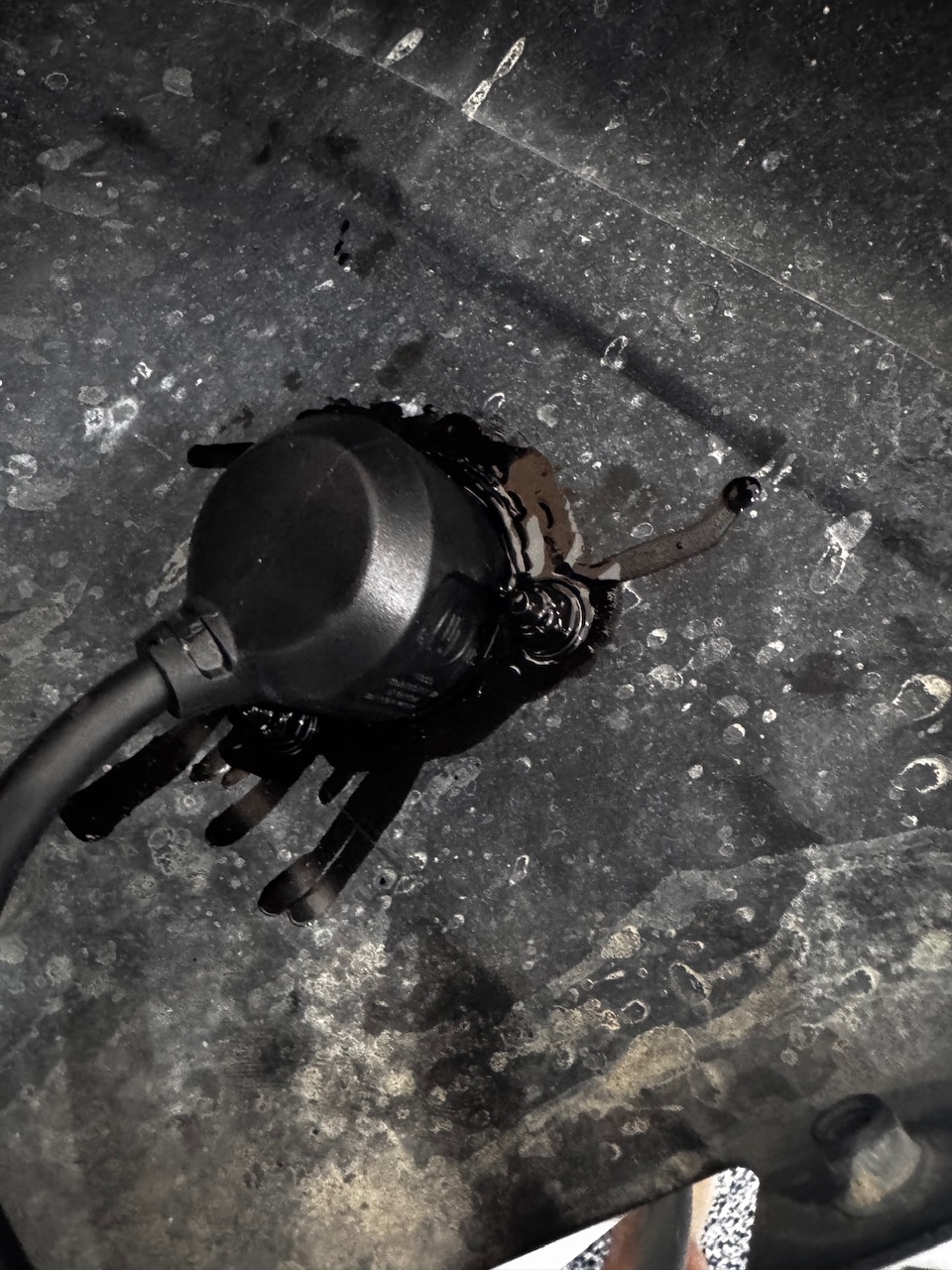

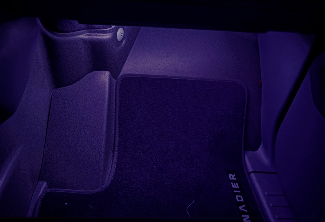

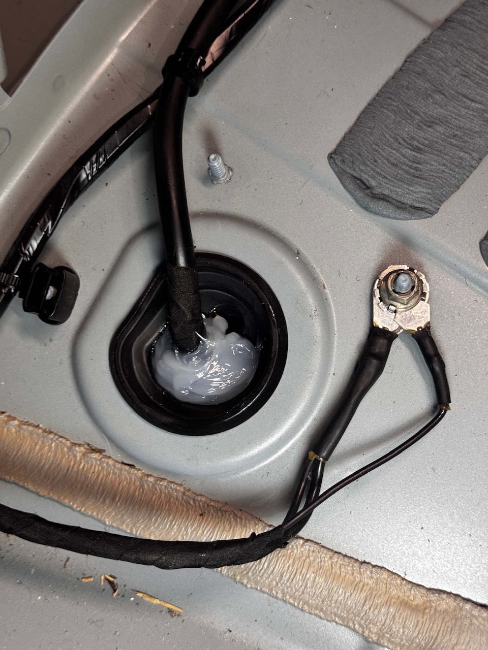

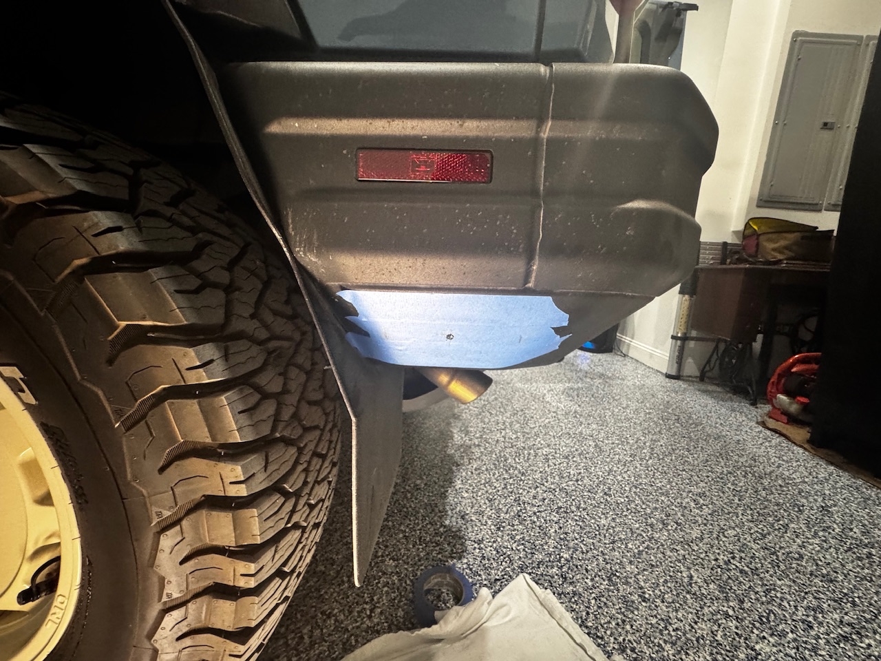

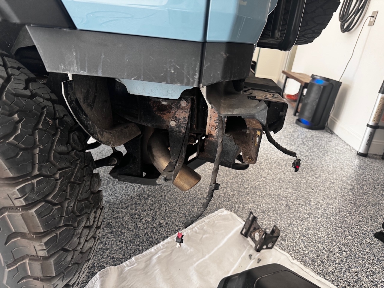

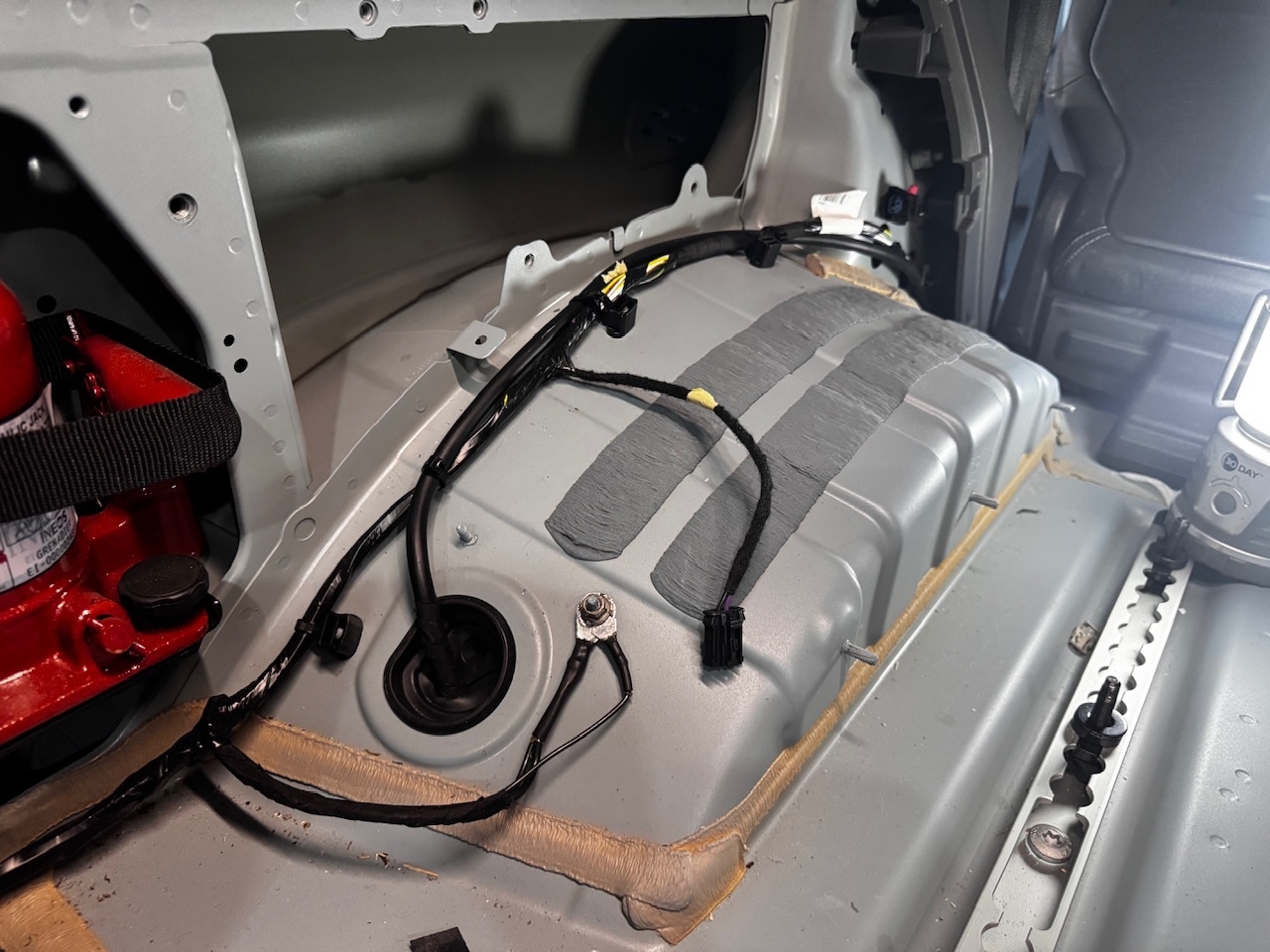

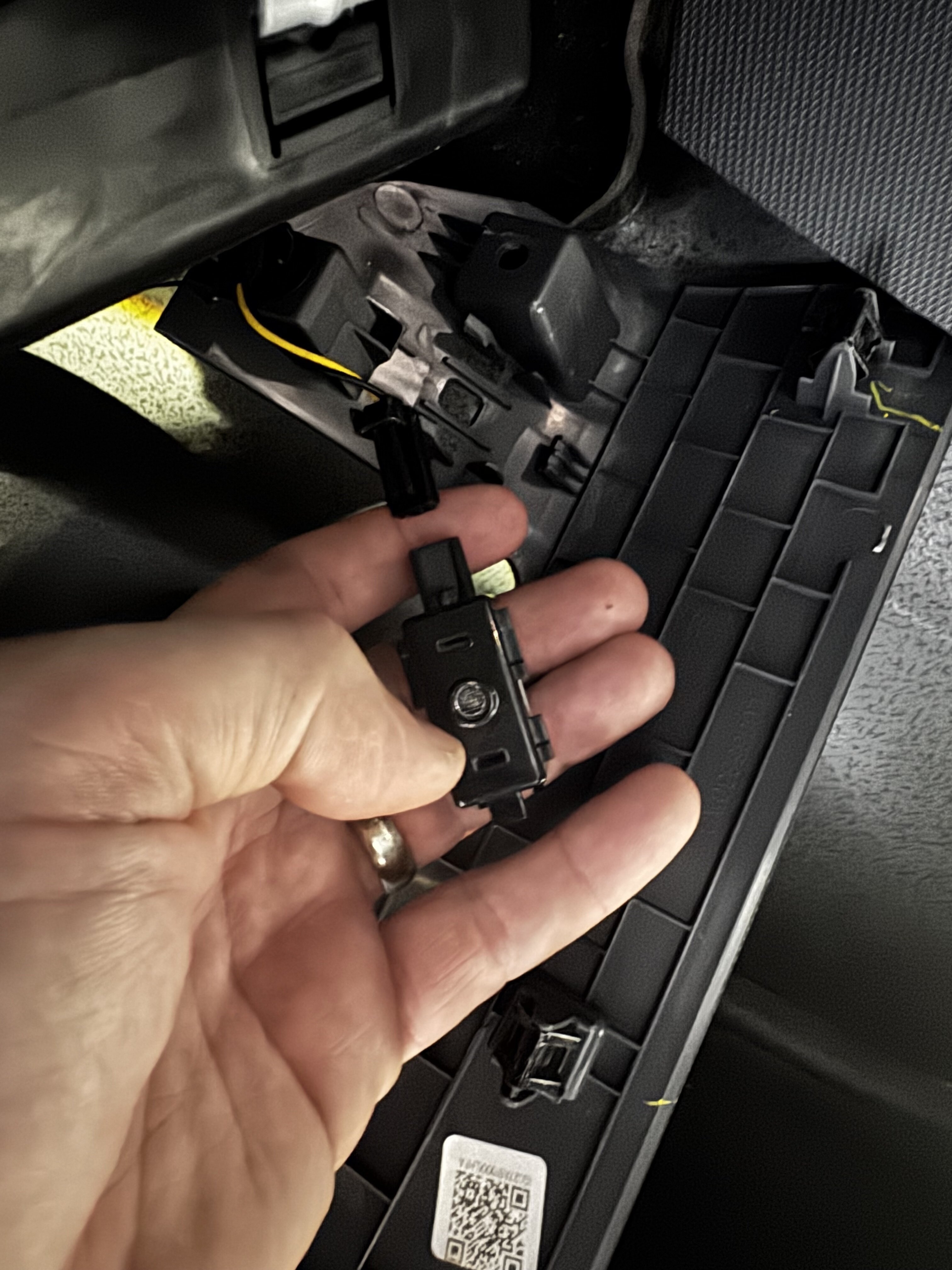

Been tinkering around…..

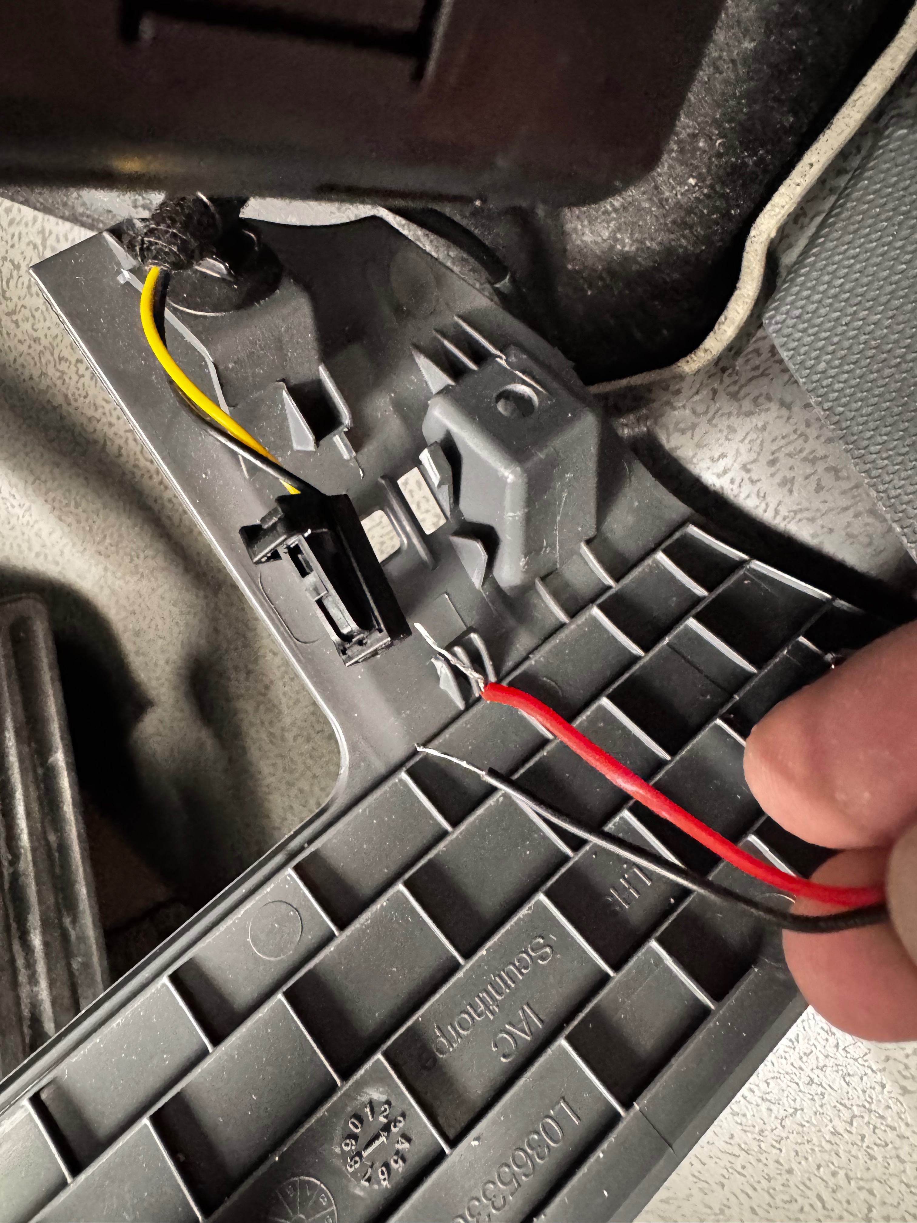

1. Added some LED lighting in foot wells front and rear. Controlled by overhead INT 1 switch. I can change colors and intensity via mobile app. I keep it at the lowest level.
2. Swapped out to the Supra shifter. It was a very easy changeover. I bought mine from a Toyota dealership in Canada / got the last one in the Canadian warehouse apparently.

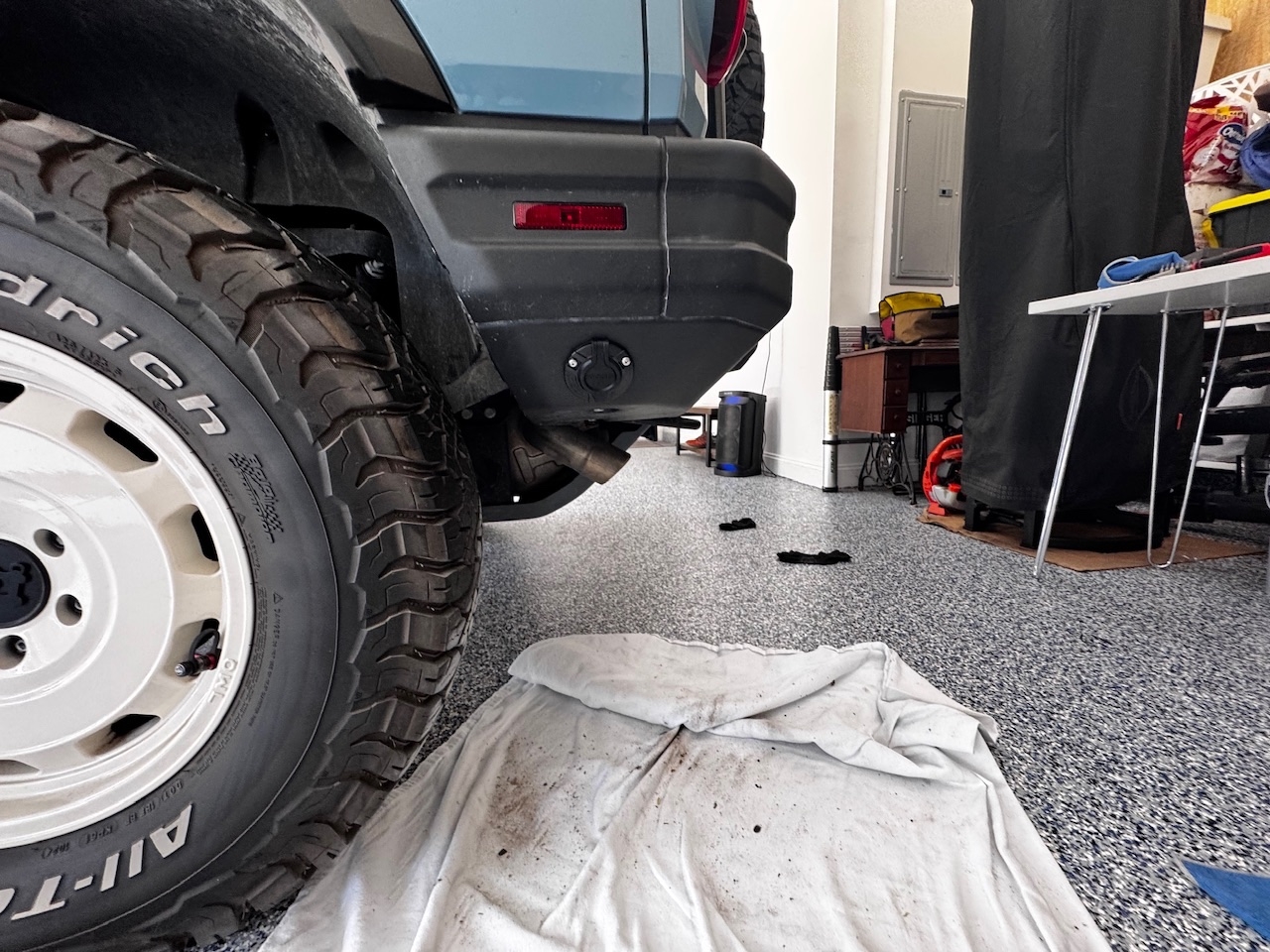

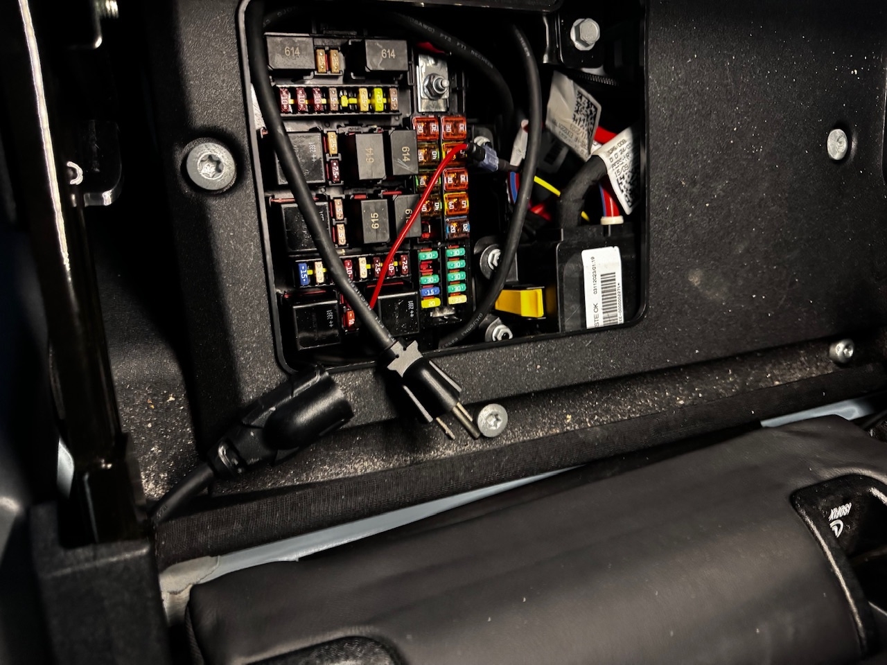

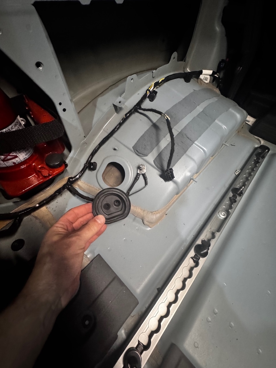

3. Added external Noco inlet for 120v power that goes to my Victron charger / power supply located under the rear seat. I leave the truck for up to 2 weeks at a time and like to keep the batteries on trickle. Also very handy at some campgrounds when running the fridge and things overnight. I can attest the the rear bumper is made from some serious steel! Took quite a while to drill through! Thank you very much to @anand for the good intel on how to ingress into the cabin.

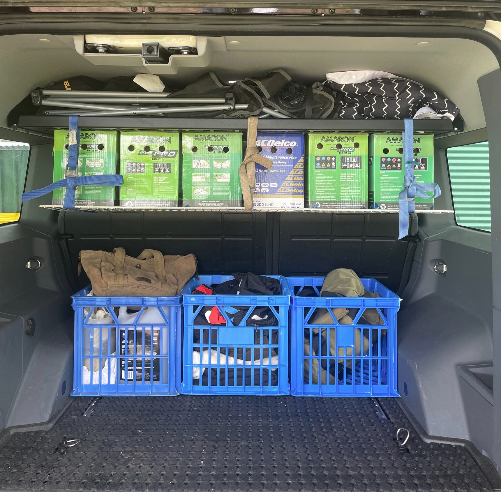

A simple mod for short and long term cargo storage, which is how I work my travel trips, trip by trip, add or subtract...I am setting off to a poultry show on Friday and will staying at Inglewood Queensland for two nights with wife and friends, so a bit of gear and six birds. It is a simply install having had the shelf from a storage system to use for this purpose.
The repurposed battery boxes with the right amount of ventilation will carry one bird each [Old English Game]. They are supported by the shelf and fixed in postion by shortening the straps and pulling up to the shelf above to make the cargo stable...what I'm liking is this can be used for multiple reasons which suits your trip by trip packing...the straps go from the back of the top self under the bottom self to the front of the top self.
I have used the old crates for years being light, strong and stackable, couldn't believe how they fitted the Gren and when the back seat is laid down the crate height is the same, so now I am working on a simple foldout board for sleeping and simple removal. A different crate for all circumstances, cooking gear and then the beer crate and so on. (y)

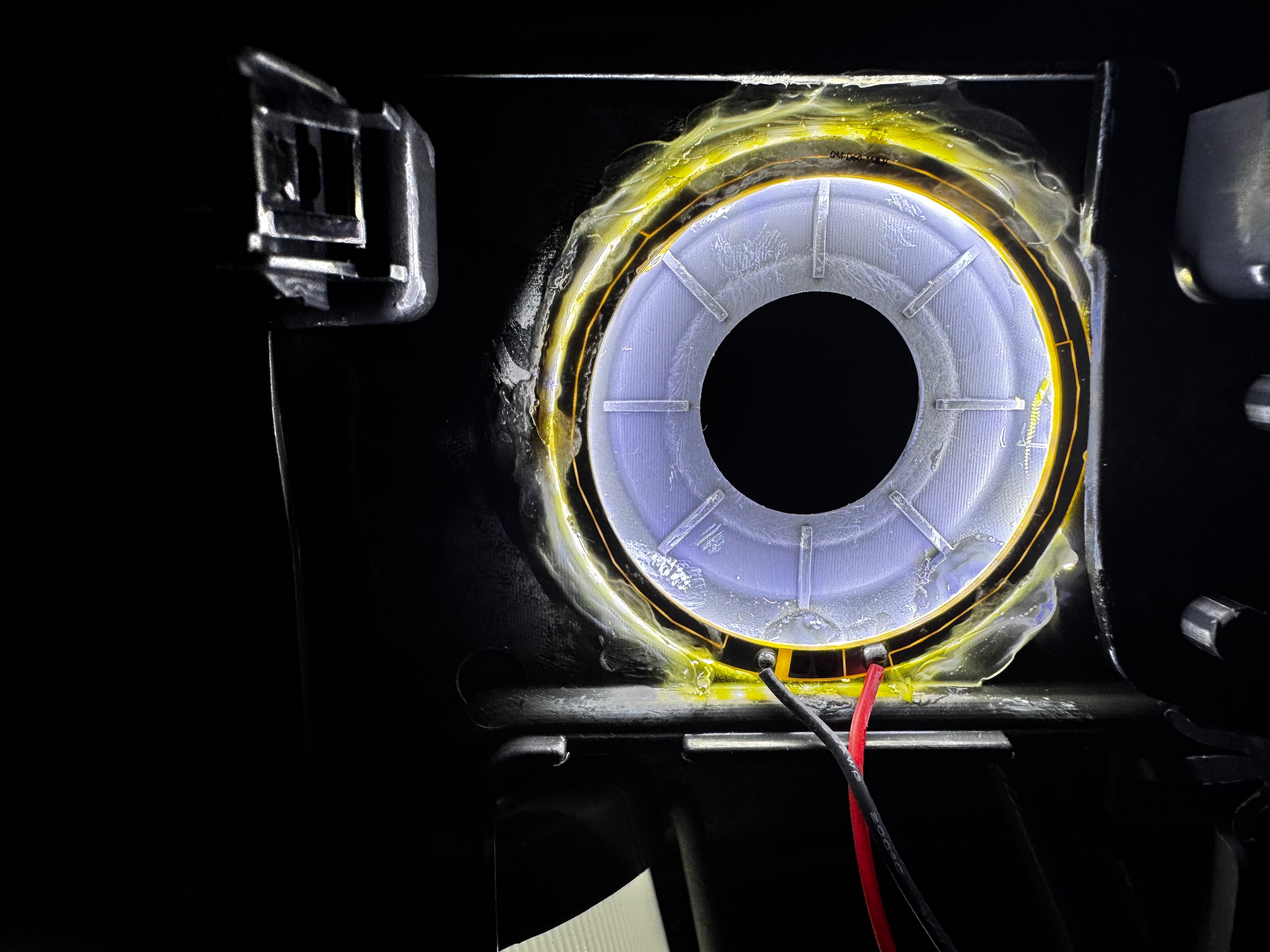

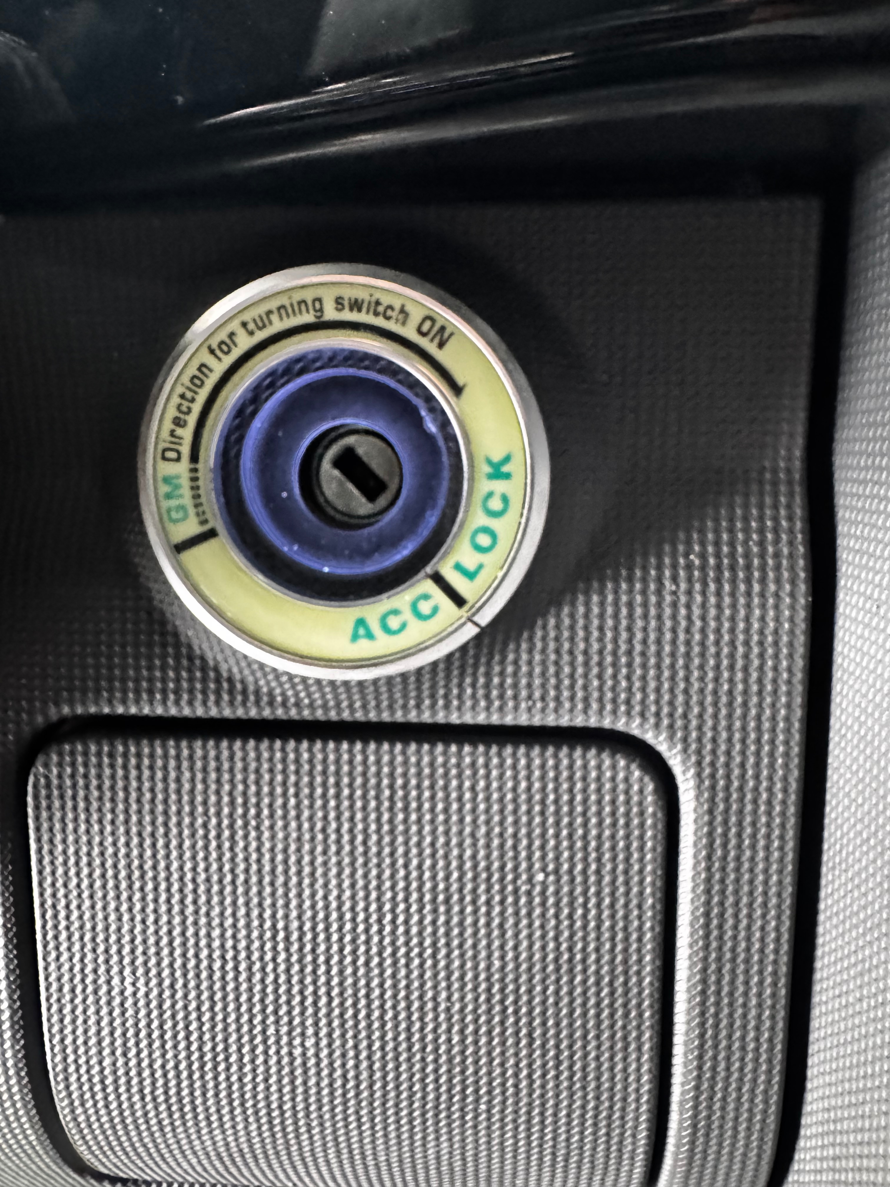

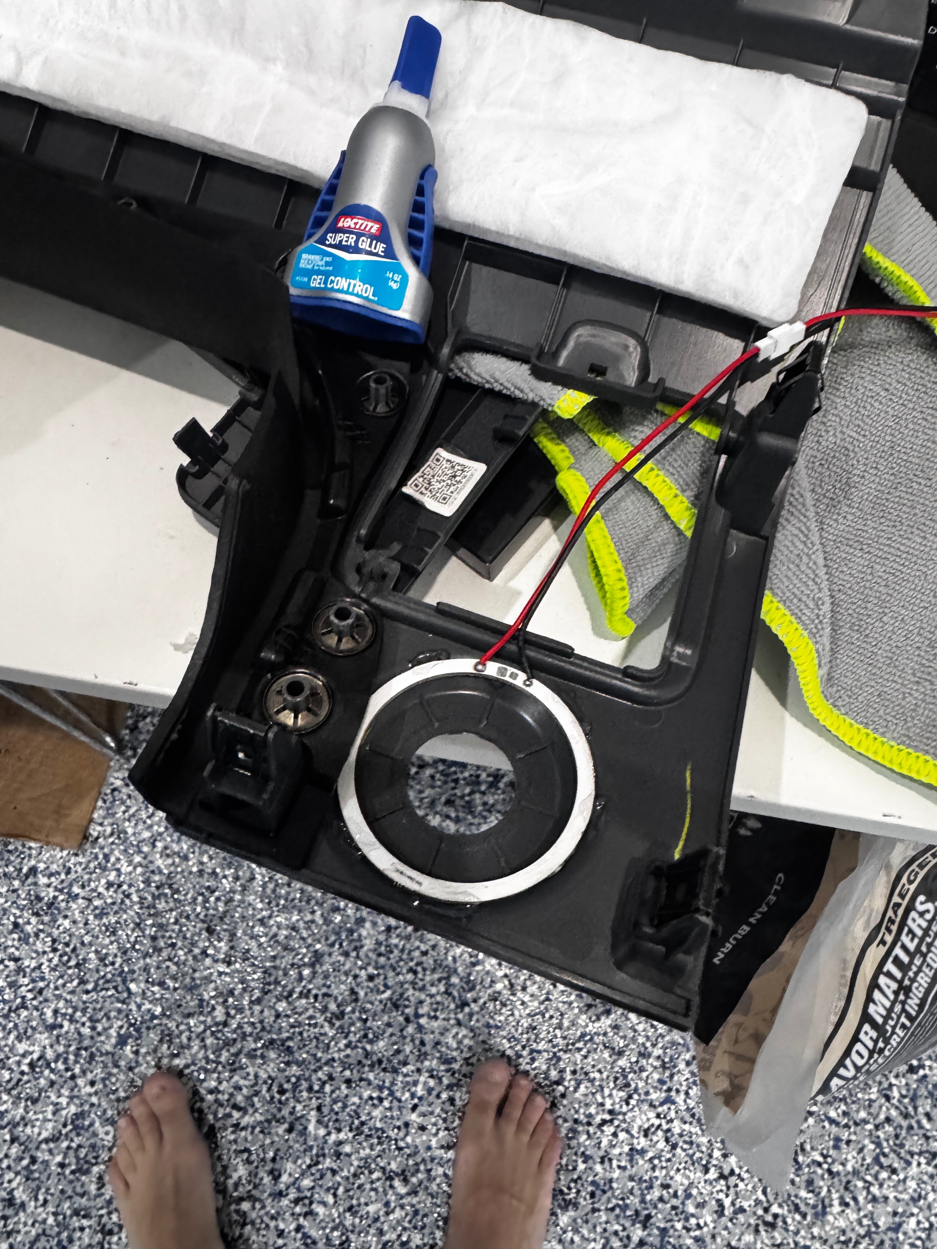

Not my idea but got this from someone else on the forum...
I bought a round "halo" LED light (60mm), glued it to the back of the panel where the ignition / key hole is, wired it into the existing LED light in the footwell, used some foam to block unwanted light leakage and works like a charm.
It automatically lights up with the interior lights now when you open the door, etc..
