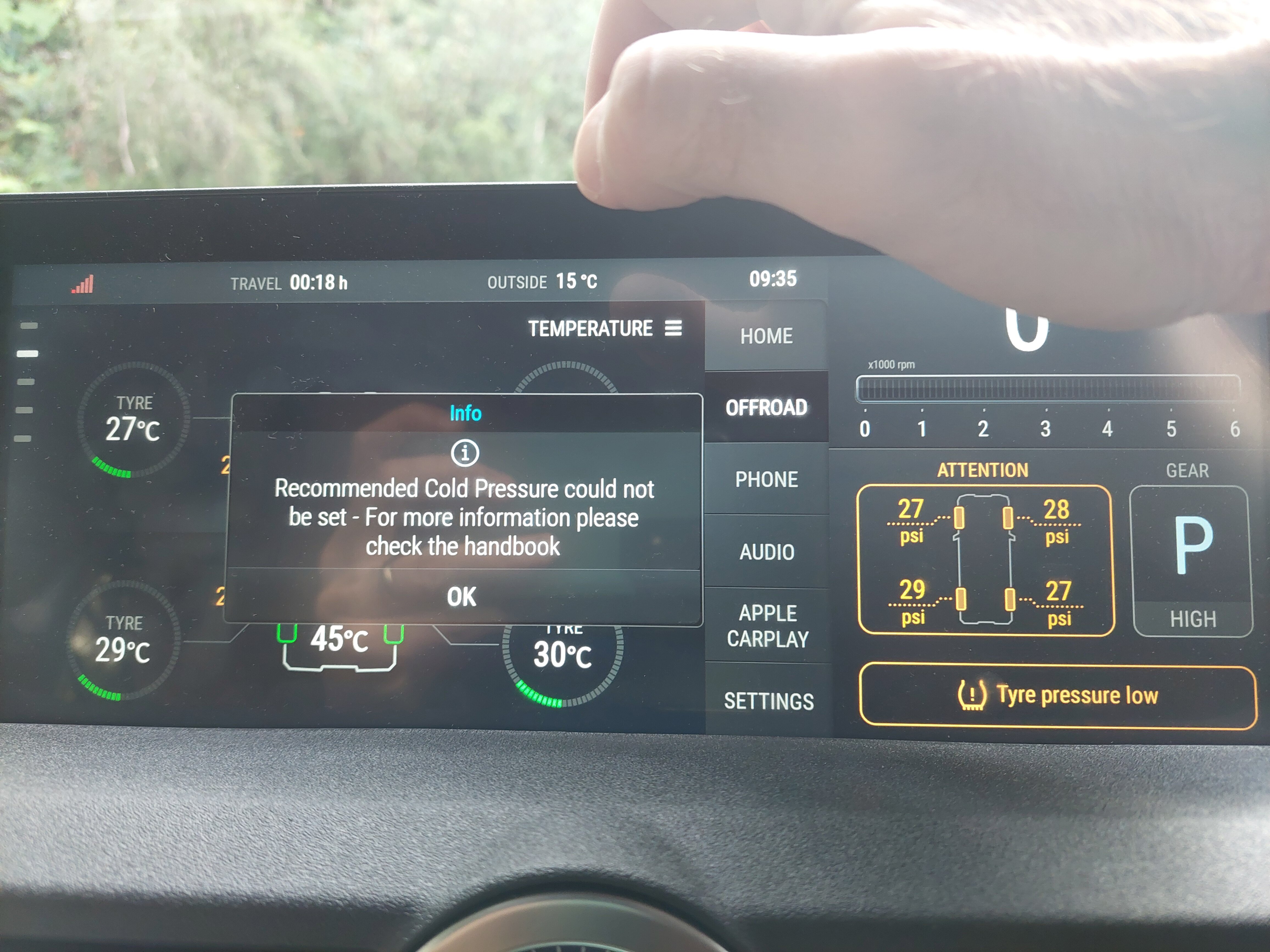

I get this error in the pic most of the time when I try to reset the tyre pressure - I guess it won't let me reset the "cold" tyre pressures when the tyres are warmer than ambient temperature.
I also regularly see 2 tyres which are at the same pressure with one saying the pressure is "low" and the other not having any warning/orange text.
I just don't understand why they would only let you set the tyre pressure when "cold". Would have thought that most people would drive to the service station, pump up the tyres and then reset the tyre pressures (but you can't because the tyres are warm after driving to the service station)
Same happens when I go 4x4ing. I drive a few kms at road tyre pressures then reduce to "off road" pressure at the trail head - but again you cannot reset the tyre pressures (so you have to spend hours offroad with the "Tyre Pressure Low" and the "bing" warning sound every so often).
Hope that gets looked at in a future software update.
And the error says "For more information please check the handbook" - but the manual provided does not have any more information....
