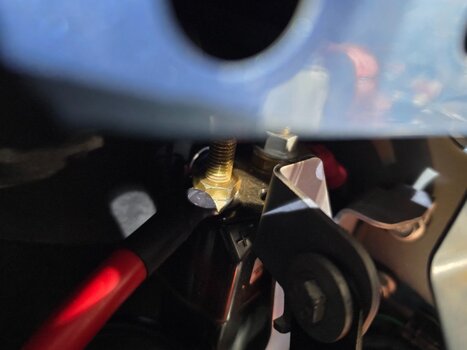

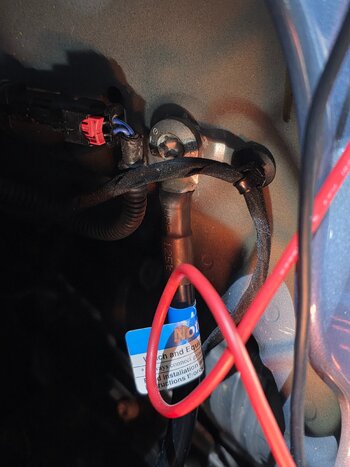

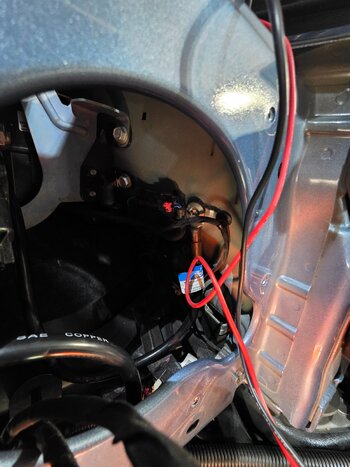

Installed the winch today. It took me a minute to figure out how to disconnect the batteries, but need to disconnect the negative terminal on the battery connector if you have a dual system, then disconnect the negative terminals on the main and aux batteries. I connected the positive from the winch on the open terminal behind the right headlight and the negative to a threaded hole in the same area, after grinding away the paint and using a bare bolt. I had a bad connection using the bolt to the front of the positive jumpstart terminal in the engine bay. Hopefully the pictures attached make it somewhat clear.

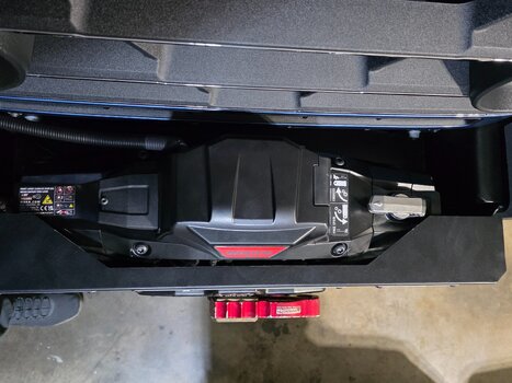

I needed access to the barrel after installation to rotate it when I was pretensioning the line, had to remove that center screen. I think I'm going to leave it off. Also, and this is just me, I mounted the side screens on the interior like it shows in the install photos, I think it looks a little better.

Yeah not sure if I keep the screens on the outside or not. One of the hardest parts was installing the winch rope. It was almost impossible to pull the loop through the barrel opening and had to use some thicker wire since the one that was supplied was not strong enough. I still need to pretension the rope at a later time and get to winch in right spot (probably move it back a half an inch or so) so I can fit the winch cover over it.

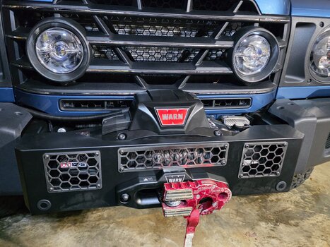

Here's a better shot. It doesn't stick out all that far.
To me its aesthetically fine. Not as slick as a hidden, but man I was sure glad to have that barrel access when I was pre-tensioning since I stupidly pulled out too much line while daydreaming 😆

Yeah I agree it doesn't look bad. I came from a Bronco Everglades which has the winch slapped on the front bumper from the factory and was sticking out as well. I just think it's nice to have access to the winch
