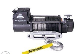

Also from looking around the width between the frame rails restricts the type of winch and specifically the length of the winch motor when a hidden mount is used...
For example the Superwinch Tigershark 9500 (an entry level winch) will fit with the solenoids mounted remotely but the 11500 probably not.
