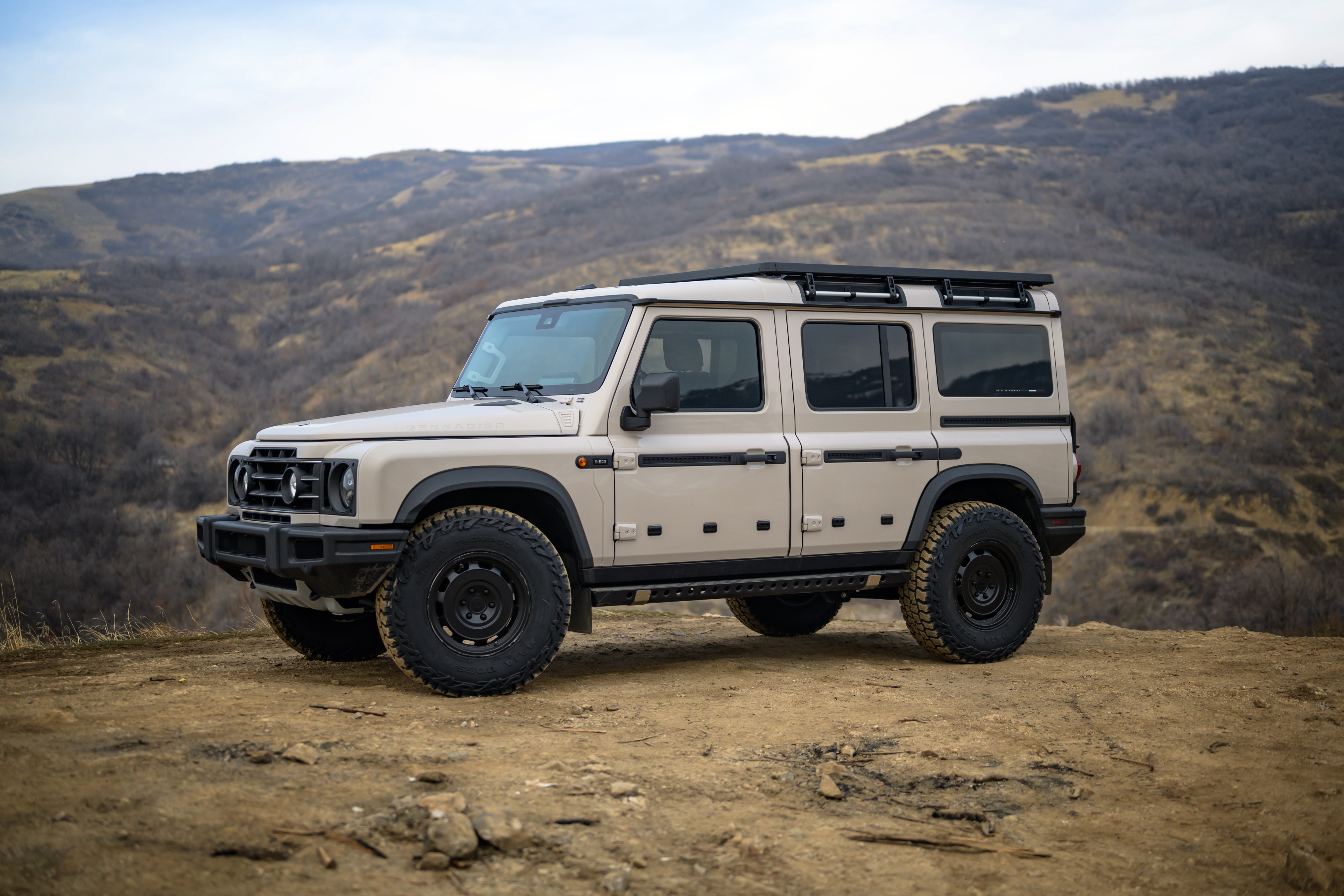

For comparison these are Goodyear Duratracs 255/80r17 on stock steelies, no lift. Great fit, no rubbing.

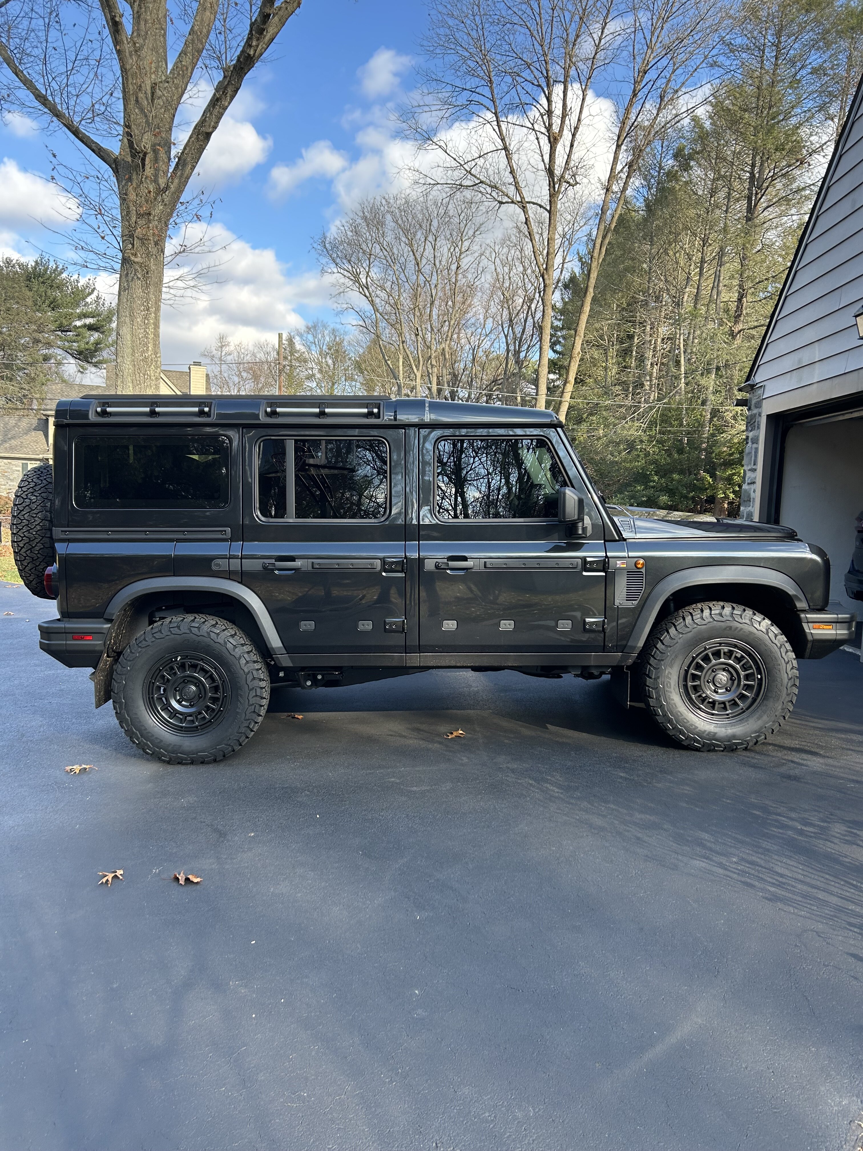

Here are the MT 255/85r17 on Owl Sixty wheels w/stock suspension. View attachment g-6.jpg
