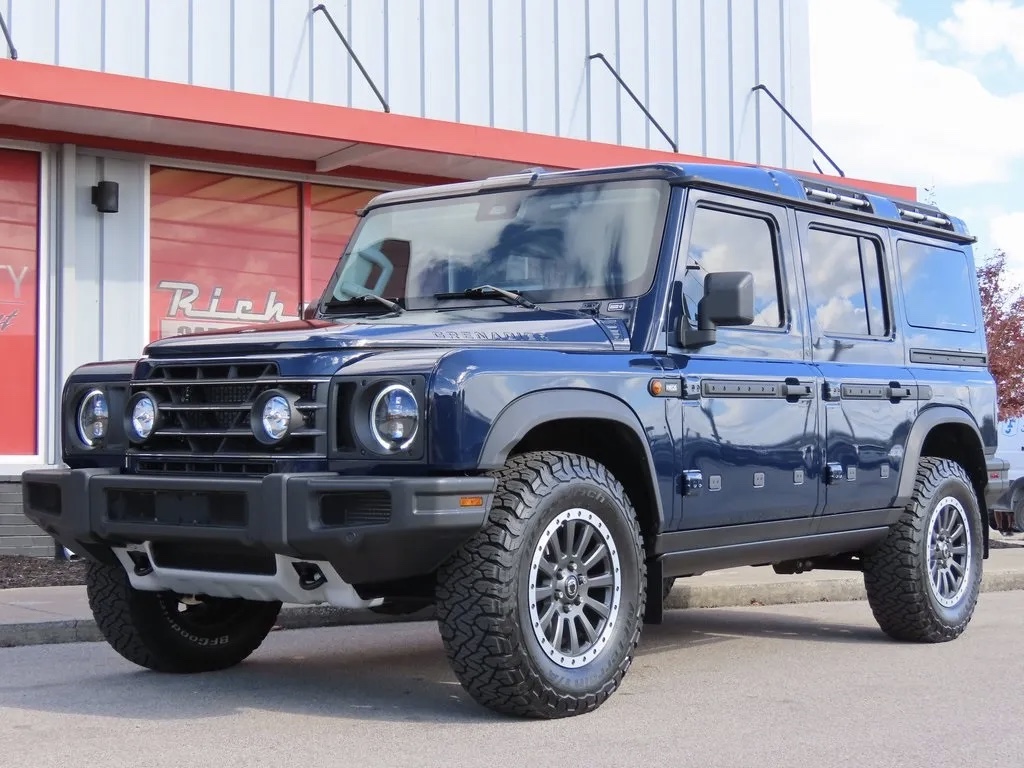

Mostly likely a question that will get a lot of “Why would you want do that?” comments but has anyone fitted 285/65 on the stock 18” alloys? I would like a little more width and a touch more sidewall height as I think this size works out to around 32.6” tire which is ideal for me as I’m not looking for supersized balloon tires or end up with the Tonka toy truck look. I plan on keeping the vehicle suspension stock and down the road may entertain a second set of 17” aftermarket wheels for off-road duty but I’m open to other suggestions.

oh that is great then, Dumb question number two does the MT 255/85/17 fit on the stock steel wheels and still work or do I need to buy a set of OWL wheels?
No need to purchase new wheels. I just had them installed on my truck and they look great on stockn17” steel wheels. I’ll post a pic. They are also not any louder than the BF Goodrich’s. I am sure my gas mileage will suffer. Truck looks so much better! The proportions are right now!

I just been through this exercise. I would say that Mickey Thompson 255/85/17 A/T tires are the largest without a lift. I did not want to lift my truck because of the issues with the drive shaft, thus, I went with these. The tire is actually 34.6” which some say is taller than typical 35” tires. The width is around 10” which is less than a 285/75/17. I’m told that these do rub because of the extra 2.5”’s. I am very happy with these …
I did purchase a relocation bracket from Owl in order for the rear door to open. I did have to purchase three 14m x 1.5 50mm bolts as the ones in n the kit do not allow you to mount the tire in reverse. I wanted to keep the original tire cover , thus, the reason for the longer bolts. The ones supplied are too short.

I guess at the end of the end it’s all a matter of preference. I have a set of 285/65/18 on my DISCO II and it looks great! Proportions are spot on. On my Grenadier I always felt that the stock size didn’t look right. I wish the truck would have come with a little larger tire, however, I understand that they were probably concerned with gas mileage and availability concerns world wide with bigger tires, thus, choose a common size that is readily available. I too was a little concerned about going too big or lifting the car, thus, I went with 255/85/17’s. These tires are slightly thinner than the original. They are about 10”, thus fit inside the wheel well. They are a 34.6 in height and I feel make the truck look much better proportionately speaking while not having the tires stick out of the wells. These fit without any lift and do not rub at all even when fully articulated.

Fantastic. I really want the 255/85 but not particularly drawn to the Mickey tread pattern. Have you driven them in mud?
No, I particularly went with MT because min snow up in big bear and was told these work better than BFG’s. I’ll probably find out soon. Although personally I don’t mind the aggressive thread pattern. I also wanted a 10 “ tire.

Thanks for the input… I did run across this setup looking around online 275/70 on the stock 18” alloys. I think it’s a really nice balance of a little extra muscle, ground clearance while maintaining an overall stock look. I just wish they made this size of the KO3s in blackwall as I’m not a big fan of reversing the tires to hide the white lettering. I like the OEM+ concept without going over the top but everyone’s styles are different and that’s okay.

So back to tires. It appears that the width of the tire is a greater limitation than the diameter especially without a lift. IIRC Ronnie Dahl put 50MM springs and still had some minor rubbing at the limits with I believe 285/75/17s.
It seems like 11-11.5 inch wide tires are about the widest you can go if you are going larger than 33" tires and want zero rubbing. Is that a fair summation of results?
