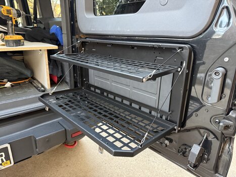

When I installed mine I used a washer and some spacers I bought from Lowe’s. They placed the table barely past the plastic access door, so I ended up grinding off the top portion of the bottom back piece to allow access. The ground-off edge sits below the bottom table piece so it’s not visible. I wanted to have the table sit as flush to the back panel as possible. Great buy!!!
Do you mind sharing some pictures of what part your trimmed and how it looks? Thanks
The spacers I used spaced the table just beyond the bumped out portion of the door, without rubbing the plastic panel. In the pic you can see where I used the grinder. Yes I’ll be painting the edges, I just haven’t yet. The removable door just barely slides in and out perfectly. I wanted the table as tight as possible with leaving scrape marks.

I finally got around to installing my rear table this evening that I got for Christmas. There were a few things that I had to modify to make it work properly.
1) Similar to others I had to drill six additional holes to line up with the factory holes four on the top and two on the sides.
2) I also cut off the lower section of the opening on the main back mounting plate to allow access to the factory cubby in the door where my OEM tool kit lives.
3) I painted the cut metal section and the new holes in black paint and it nearly matches the powder coat finish, so I’m happy with it.
I used the 17 mm hex spacers which spaced the table about 3/4” off the factory plastic panel. I had some automotive washers with impregnated rubber that tapers and they fit perfectly in the tapered holes in the factory plastic cover. I knew I saved those for some reason! With the spacers and those rubber washers, the table sits about 3/4” off the plastic panel.
I have the Solid Wood Worx drawer system and with where I have it installed (theres a bit of tolerance with the mounting) there’s 1/2” of space between the table and the drawer face with the door closed so I’m happy with that.

Thanks everyone for the insights and pictures. Just put mine on. The black nut threaded spacers were a bit of a PITA for me, probably because I tried to put them on all before mounting it. I also wanted something that would engage the back plate.
So I printed some new, non-threaded spacers. Takes out the need for the washers and threaded spacers.
I’m happy with it as it- but you can see that the spacers I printed a bit shorter, which I thought would be fine- but… since they are a bit shorter, it makes getting the storage panel a little hard. With the standard Black nut spacers, how accessible is the plastic door? I think I’ll Print out ones a bit longer to make the door more accessible?
I did go and got some M6x40mm black screws, I started out with the included silver screws, but they seemed a bit long.
I like it so far. Seems tight, not rattling in a short drive to test it out.
