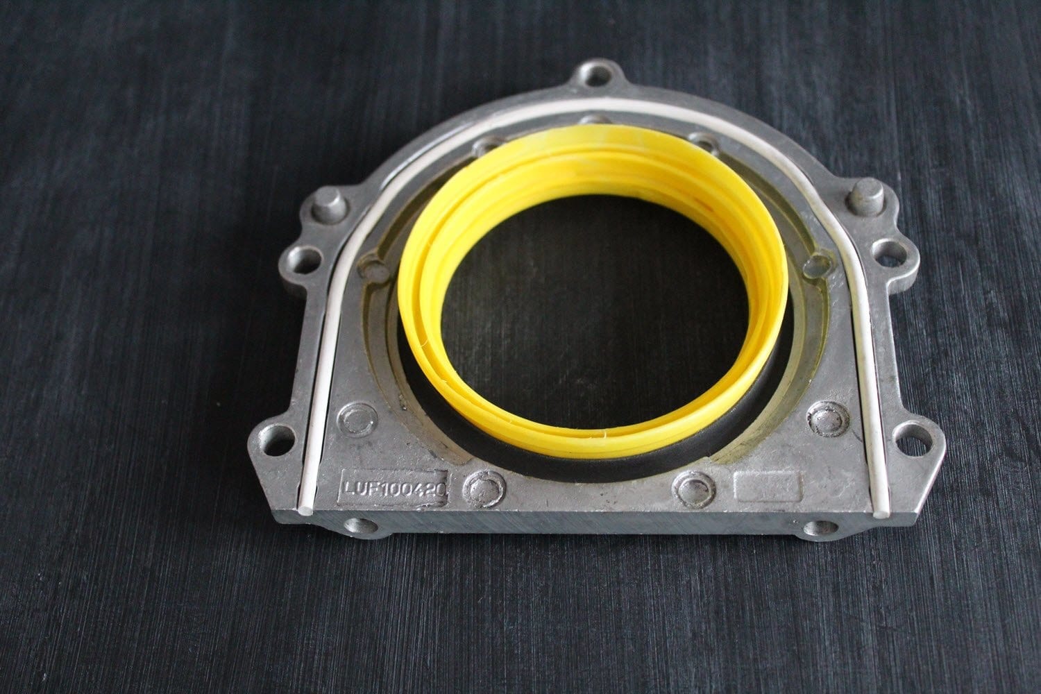

You may recognize them as they often have a mounting aid, which is removed after mounting the seal.

The mounting aid is pre-installed on the seal, it is not a tool, it protects the seal. When you're finished mounting the seal you take it out and the seal gets into contact with the surface.
Can look like this (yellow part):
But, what I said was just a guess. Could have been...
