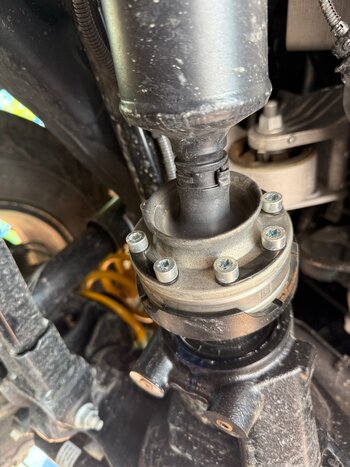

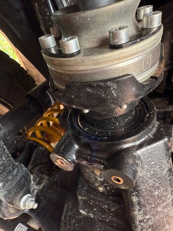

Did a bit of gravel travel yesterday, quick look underneath today only to find the front pinion seal leaking.
Vehicle is 2 months old, stock suspension and tyres and the dealer is 8hs away!

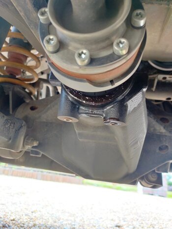

Front diff, 2023 model , stock, 14000 miles. Slight leak, not enough to show on the driveway. Hopefully it will be fixed at year 2 service in August.
