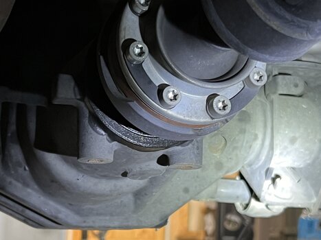

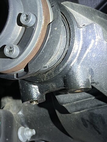

I was doing routine inspection at 7k miles yesterday and noticed that both front and rear pinion seals at the differential seem to be weeping / sweating a little. No oil on the ground and discoloration around the seal is somewhat minor.
Is this normal?
Here's mine. Any more updates from anybody? Thx!
