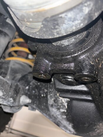

Well this inspired me to crawl under the truck, and I shouldn't have. Because ignorance is bliss. Front seal is leaking, installing a breather and then getting the seal addressed.
No oil on the ground, but dang this thing is behaving more and more like my old defenders.

That should take care of it! I hope.
