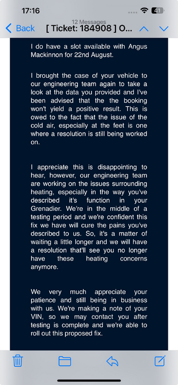

Ineos are working on a solution
See attached file from customer support
